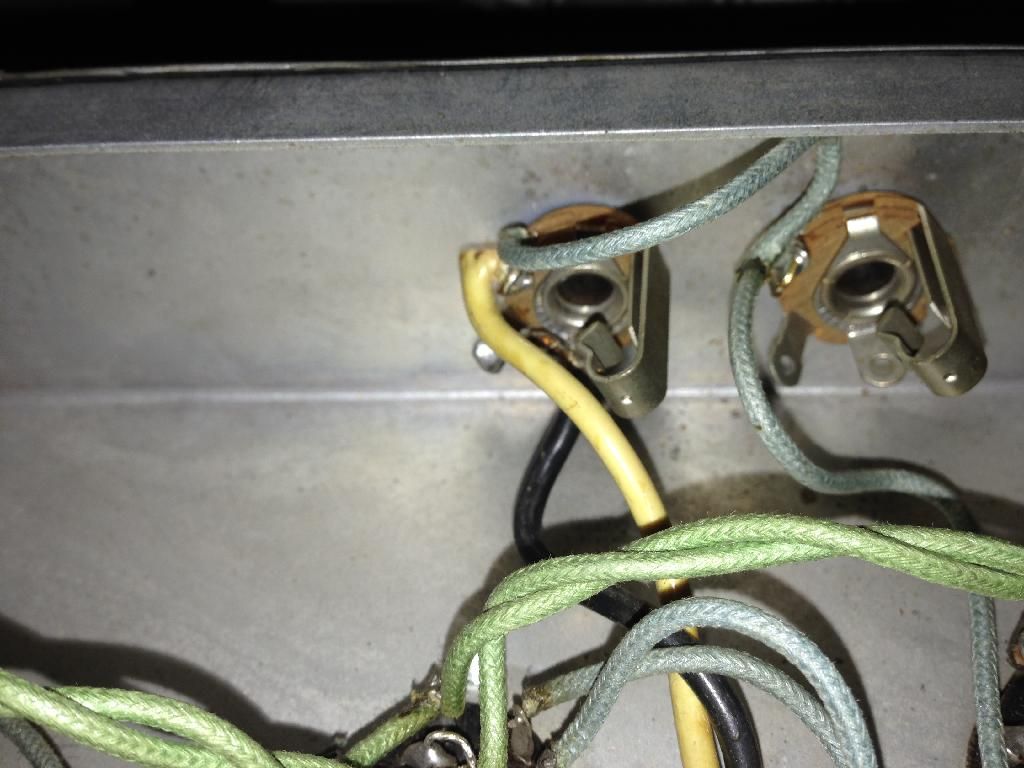

Here's one that's got me stumped; I know a stock Traynor YBA-3 has series speaker outs, and has a fixed 8 ohm impedance. But I know some problem modify the outputs to parallel, since it's not common you'll plug in two 4 ohm cabs. I happen to have two 4 ohm cabs, though, but I'm not sure if my speaker outs have been modified or not. It's got one terminal, going to the exact same terminal on the other out, which to me sounds/looks like parallel. But I think parallel would require both terminals going over. But I also don't know if the way it's wired now is series. Haha. That might sound confusing. I can't quite read schematics well enough to know, either. As it stands, plugging into the extended speaker out *only* will not give me any volume louder than whispering. But works fine when only the regular out is plugged, or when both are plugged.
So I just wanna know if my outputs are series like they should be, or have been modified to parallel. Halp!

400 Watts
That ^ looks series to me.
