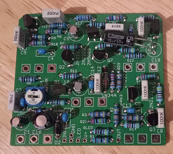

Anyone confirm the pcb or stompbox layout as working yet?
- eatyourguitar
- Posts: 3127
- Joined: Sun Oct 03, 2010 12:37 pm
- Location: USA, RI
Re: INFANEM the driving notion clone
a few days maybe. I am in school right now. I have very little time to do anything. I made it this far. there were multiple parts orders to get things to this point. now I am working on a drill template that I will share for 125B enclosure. I am using 6n8 kemet mmk series box film cap where the schematic shows 7n5. it was that or 10nF but I wanted to try 6n8 before 10nF. even though I have old stock J201, I ordered new J201 from mouser to rule out any fakes. the germanium diode is purchased from various sources but they are all tested and verified. I did not have 2N5089 but I did have 2N5088 in stock. I can always build it again if I don't like it. 1uF is ceramic TDK I think? the board is not setup to handle 1uF film caps. 50K bourns trimmers not in stock so I used tayda trimmers. I didn't want to wait any longer. chong cap because I ran out of kemet or panasonic 10uF. I have all the pots here. I was going to build the deluxe but I am probably not because I don't have the metal bar to protect the toggle switches. I want the pedal to last a long time. these metal bars are from RAF but the minimum order is 50 pieces. they are $5 each? not spending $250 on a bag of metal bars.
