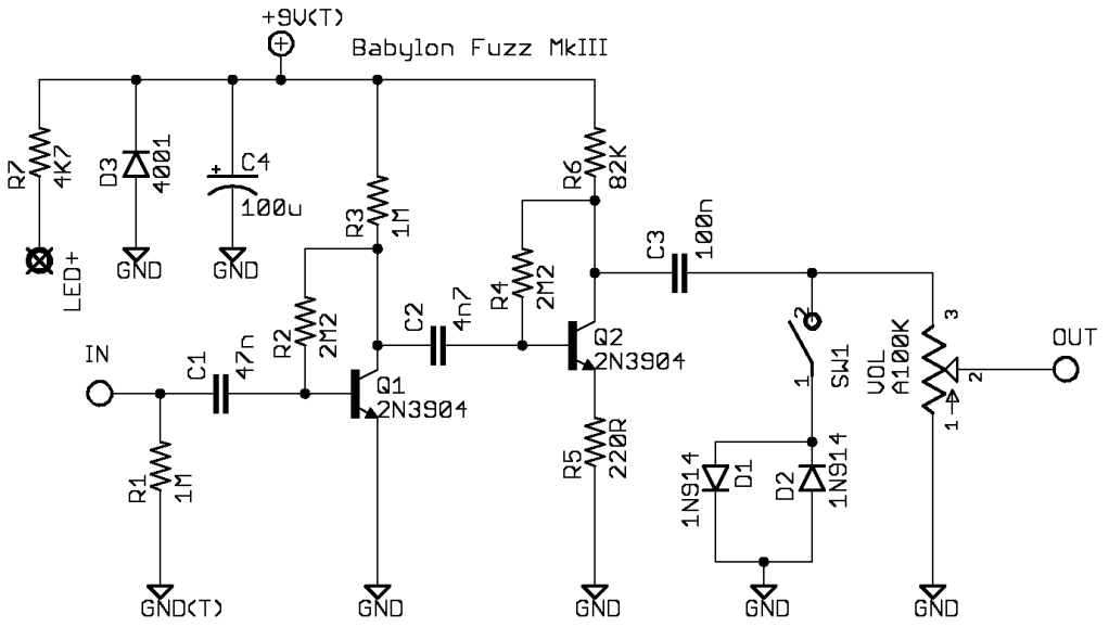

Jero wrote:Switch for no diodes? What's the overall gain like? I believe a portion of a circuit I've been working on is similar to your Babylon
Yes, the switch is for the diodes. The MKI and MKII didn't have diodes, so the switch *adds* diodes, from a historical perspective. :lol:
Here is the schematic:

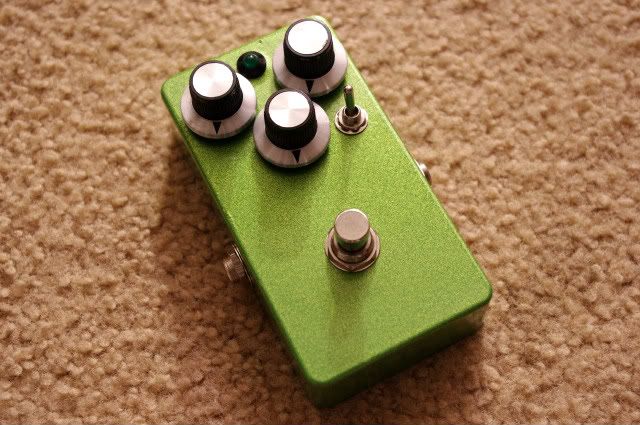

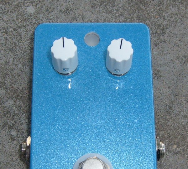

Built a fuzzrite today. Didn't have any 5mm bezels so I made a filtered window of sorts. I like it. Not sure where the blue and white motif spawned from.

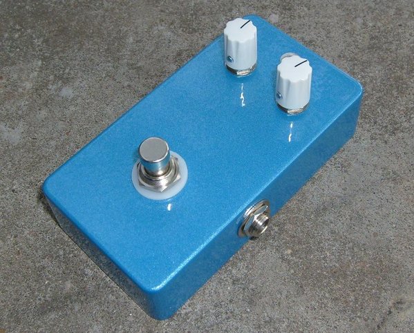

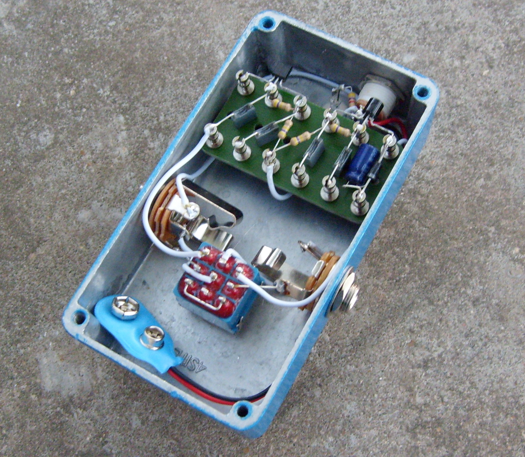

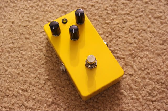

Made a pair of these :
I had to check that off the list of things I've built as I've only played another persons clone. Needless to say it's even better than I remember it being :thumb:

Jero wrote:Built a fuzzrite today. Didn't have any 5mm bezels so I made a filtered window of sorts. I like it. Not sure where the blue and white motif spawned from.
Damn son, puttin' my last fuzzrite to shame.

I really like the idea of the inverted film caps as well, nice build.
StupidDream88 wrote:Made a pair of these : Image

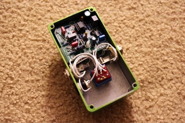

For a second I thought, "Ezekiel!?" but that's not it. :poke: ...maybe a rat?
Having the caps inverted makes it really easy to work with, and saves space. On the other hand, if I didn't put the board on the pots, the height wouldn't be an issue.
Rygot wrote:Damn son, puttin' my last fuzzrite to shame.
It only took me however long ago that was, to get around to making this one :lol: Didn't you do some mods to it?

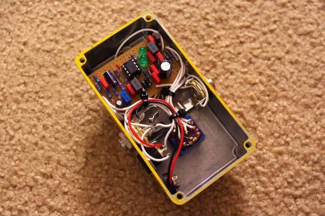

A little tubescreamer fun...
