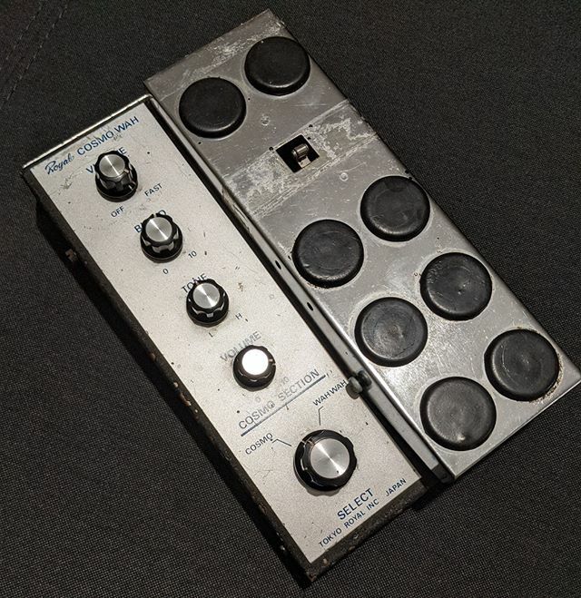

Here at Dead End FX, we're currently busy resurrecting the Royal Cosmo Wah.
If you think that the Mold Spore was a cool idea, this is the genesis. Lost, but not forgotten.

digi2t
Posts: 779
Re: Ring (and/or Balanced) Modulation for the masses
Post by digi2t »
The trace and breadboard test are conclusive. It's now in Phil's hands for PCB design. This will be a Dunlop wah shell drop in board design, similar to the Tresonator. The beauty is that the 100k Hot Potz works really well with it, so no need to try tracking down the vaporware M100k that the original uses. Other than that, we've replaced a resistor with a trimmer to allow for fine tuning of the ringmod vibe mix.

digi2t
Posts: 779
Post by digi2t »
Finally finished the validation build tonight. Late night headphone test is extremely promising. I'm not hearing any carrier noise or whining when I'm not playing. Full power trials slated for tomorrow. :drool:
http://www.deadendfx.com/
digi2t
Posts: 779
Post by digi2t »
OK, had a moment to make a quick sound snippet video of the Cosmo King. Still in my jam-jams, which I think is a precursor for the day.
I figured out why it was popping when I switched modes. It's because I had the Laika in front, and on. Doesn't like that.
I thought I would be getting way more carrier bleed through when I wasn't playing, but surprisingly, it's actually preeeetty quiet.
