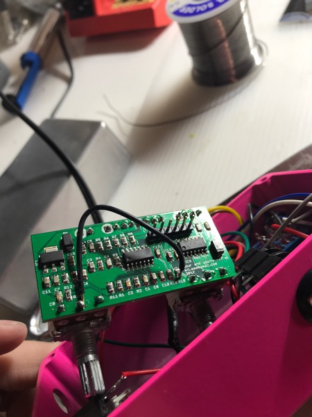

ya gonna show me how to do this?DRodriguez wrote:
Modded my pink Your & You're.
With test tone:

- JonnyAngle
- Posts: 4233
Re: Your and You're
Here is the Drod Mod
Attach the bottom of the R10 resistor to the middle lug of the volume control.
Drod added a switch and pot to bypass this mod and also blend in the stock signal. You can do that too by cutting the wire and adding a switch and/or pot.
Edit:
There is a huge volume boost by doing this mod.
Edit:
