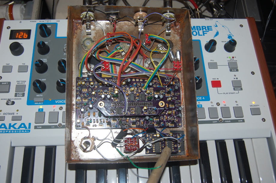

One thing I built is a "super diode" (essentially an op-amp doing servo duty with a diode to "correct out" the voltage drop) based ring modulator. The unit I built acts, differently. I was able to null the carrier out completely (I say that without playing it on a big system, mind you) and the standard input brings the carrier in to follow its envelope, but actual mixing of the two sources seemed additive as opposed to multiplicative. I plan on experimenting with different opamp topologies in this application. As is, it's kind of cool as a sub-function, but not something to blow your socks off. It needs more run time before seeing the light of day.

I just shipped the first Stone Splitter today, but I have one more practically year old inquiry to address before any actually "go live". I am looking at two partially populated PCBs as I type this, so they will surface soon. It's a complex build (see attached) and so pricing isn't going to be terribly competitive with respect to other octave divider pedals.BetterOffShred wrote:What's happening with this stone splitter I keep hearing about?any plans to sell a batch of those in the near future?
Please note, that picture depicts a floating LED wire while I point to a design flaw I was ironing out on this build (LED current through the 4066 was causing issues with heating); that face mounted jack is also a non-standard request. Here's some terrible cinematography complete with audio sync issues and low levels you can enjoy for the next 14 minutes while digesting the fact that I plan on asking $385 plus shipping for these things.
