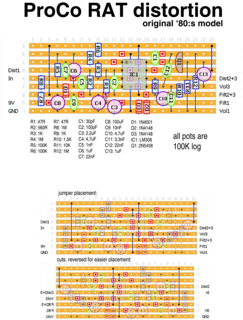

phantasmagorovich wrote:I haven't found decent footswitches at Conrad's but there's also Musikding.
This seems to be a very good project, once I got & finished my Moody Sounds Fuzz kit. I could first set it up on a breadboard and mess around with it a bit.
I do have a question concerning this schematics though. The Names and numbers at the side of the Board refer to the Pots, right? Are they numbered on the pots so that there is no mistaking? And Vol2 goes to the out jack? Is all of this right? I am still pretty much a rookie at building, but I do think I can produce decent enough soldering points. And this schematic comtrails posted is the most self-explanatory I've seen.
