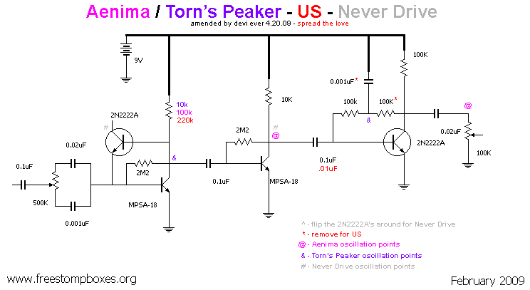

I really think that you could switch US/TP with a 4pdt switch, it would just be complicated...I'd really like confirmation from someone more knowledgeable than me, though. Here's what I had in mind: one pole toggles between the 220k & 10k resistors, the next toggles between .01 and .1 uf caps, the third pole toggles between .001 uf cap and a jumper to remove the cap, and the fourth pole toggles between the 100k resistor and a jumper. I don't know if that makes sense, but you'll see which parts I'm talking about if you look at the schem. I really think that's possible with a 4pdt, but I don't really have any kind of cool drawing program to show how to do it, so, I hope that helps a little bit...

New thought, you could also do this with a 3pdt switch and replace that first 100k/220k resistor with a pot so that you could access US, TP, and AE and whatever may lie between!

ifeellikeatourist wrote:New thought, you could also do this with a 3pdt switch and replace that first 100k/220k resistor with a pot so that you could access US, TP, and AE and whatever may lie between!
:idk:
Oh, yeah, that would be awesome. A 250K pot would be perfect. Good idea! :thumb:

have you thought about pming stanimal? he is a cool dude that just modded the crap out of a bit mangler, and he put in a switch to flip the sides of a twosome.... :poke:

i did that mod to my TP a while back. its really cool. id strongly suggest it!
