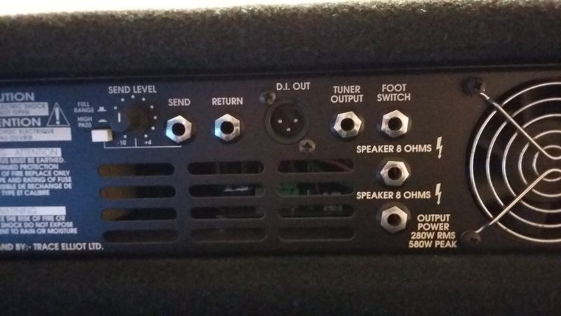

Does it say AH350 on the bottom panel of the front plate?
Dark Barn
Posts: 1801
Re: Fucking Ohms... (HALP)
Post by Dark Barn »
I ask because for whatever reason Trace Elliot was so proud of the pre-amp section in the GP12SMX series that the pre-amp got top billing above the actual amp model. They released quite a few heads that all had the same exact front plate where it says GP12SMX, and below that a panel with the actual amp model name. Although they also released a standalone GP12SMX preamp the presence of an 8ohm output on yours suggests to me that you have a full head, not just the pre-amp version.
Posts: 12558
Oh, okay. Weird. The front panel just says GP12 SMX - Bass Pre-amp. Nothing else.
This is the back of my GP12SMX
If it is in fact a head, I don't understand why I had to crank everything to get something remotely loud. I could seriously put my face right in front of the speakers at full blast and it was...meh. :idk:
Dark Barn
Posts: 1801
Post by Dark Barn »
I think that might be the AH250. Just plug one speaker into each 8ohm tap and yore good to go.
Posts: 12558
Front panel just says GP12 SMX - Bass Pre-amp though...
But then again, I wasn't the one who set it up when I tried it. Maybe he hooked it up in parallel giving it a 16 Ohm rating. Would that make it weaksauce? Hopefully we'll get the keys to the place in the next couple of days so I can check it out.
