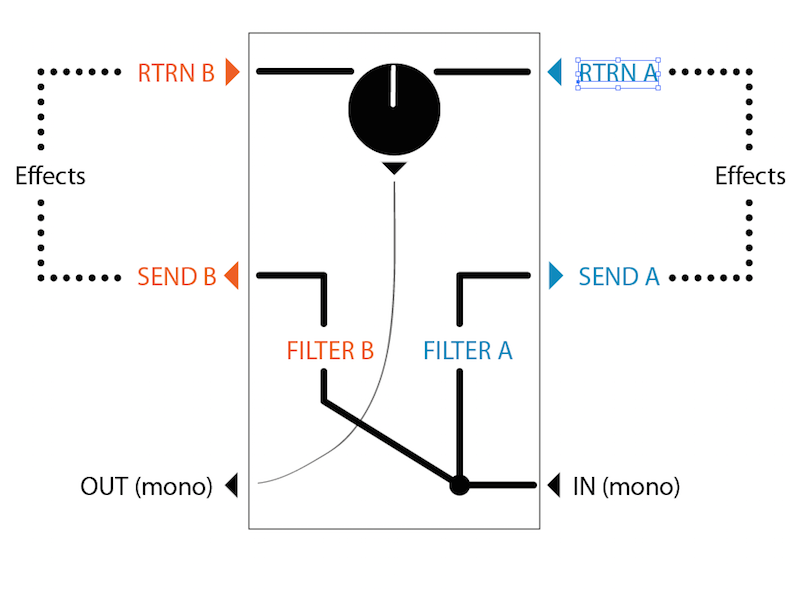

Blending a filtered signal with an un-altered is no problem. The output is always mono.
As for the Ping-Pong, that would be only possible with a bit of workaround. We talked this through on facebook already ;) For everyone else, this is a simple schematic of how the pedal works:
— The filters are 3-way switches: LP - full signal - HP
— If you leave a channel open (ie. don't connect a pedal in a loop), the path is automatically bridged and carries the clean signal
— You can also choose to use only the Returns to merge/blend two signals into one
— Or use the Sends to split your signal into two (three with the output) and do the bi- or tri-amp trick ;)

How do I use it? — the idea behind the whole project is to bring the studio concept of a parallel signal path (clean/wet) to the pedalboard. Most people having tracked in a studio know the setup of recording a track of just the clean bass sound (DI signal) to add punch to a distorted tone that often lacks low end. I actually don't have an Integrail on my personal board right now because I sold all units already. Also, because I can get a similar effect through a rather complicated wiring of my board and my two amps. But I am definitly going to have one on my board for many reasons…
The basic idea is to have your dirt pedals in one loop and leave the other loop empty (=clean). Then you can decide to use the unaltered clean signal or just the bottom end (250Hz and below). This is the way Brian wired it up on his board when he got it. The two fuzzrocious pedals are his main distortion right now (rat=medium gain, mostly always on, demon=trebly higher gain) and feeding the clean signal's low end through the other loop.
I am happy to let everyone know when the second run will be ready and all of the other details. There are 10 to 15 units in the planning, pricing somewhere around $180-200, probably with some option of wine matching since I that is my second nerding topic right now. Also there I am working on a few functional upgrades like phase switching and an expression in.
edit1: btw, I am open to suggestions on new features ;)
edit2: what I described above is just the conventional idea of the pedal. but it turns out to be a great playground for any instrument. imagine sending the low end to a flanger and the top end to a distortion+delay … or blend two tremolos … and so on
