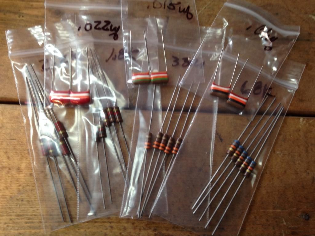

The resistors and caps. Came today.

vintage resistors do not always fit the pcb. they work better on turret board and tag board. I don't know what you are planning exactly if these are for a crybaby.

I don't know either! Just following online suggestions.

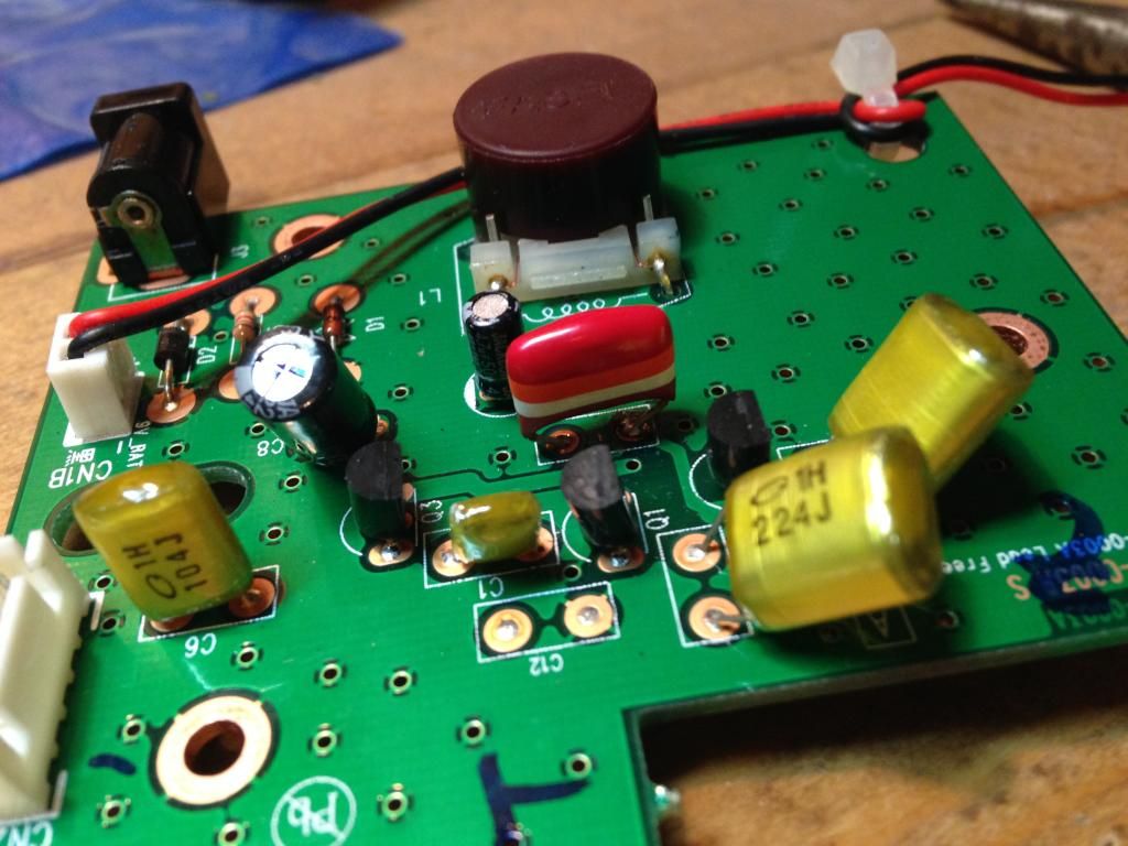

I'll be trying them also in my vox v847a... Such as this. The stock .01 sweep cap out for .022 tropical fish. Took some patience getting the cap off.. But it looks sexy.

I actually found it harder to remove these caps than the vox. Crazy.
I may have damaged the connection trying to get it to solder without touching the metal strip beside it.
I'm going to invest in a small soldering iron. As mine is big one. Maybe too hot.

So I did fuck up the trace. I managed to find a tutorial in fixing it. So I followed it. Scraped off some green coating to get copper. Tinned. Bent leads to touch. Solder. Fixed. I believe. That was on the C5 cap. Now an .022 tropical. I also changed the R1 resistor to carbon comp 1.8k.
