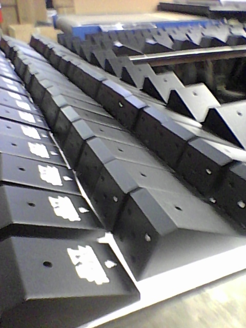

A shot from powder coating
production shots 34
production shots 34
Bob Ebeling
Jext Telez
DannDubbleEwe
Posts: 1728
Location: TN
Re: Jext Telez Dizzy Tone fuzz pedals
Post by DannDubbleEwe »
Amazing!

Totally love the enclosure! Sheetmetal, welded edges? So great with the knobs all on the huge top end panel...
