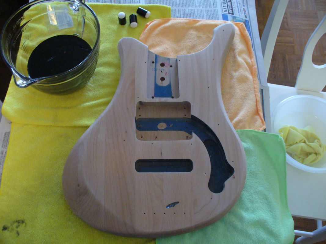

Hey, tell me if this would look terrible or not.

i'm afraid of 100 grit. for me, 220 is right on the edge of tearing up the wood too much.

MAN THAT LOOKS AMAZING SO FAR HOLY SHIT THIS IS GONNA RULE

skullservant wrote:MAN THAT LOOKS AMAZING SO FAR HOLY SHIT THIS IS GONNA RULE
AGREED!!!

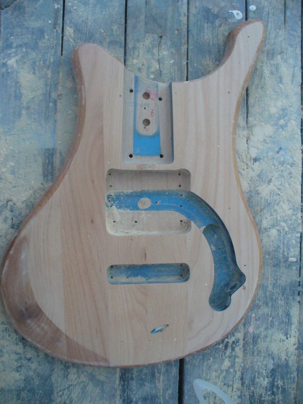

Phew, front's stripped.
Plywood4lyfe
My back will probably never forgive me...

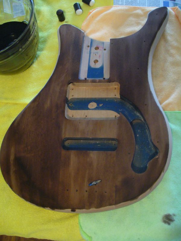

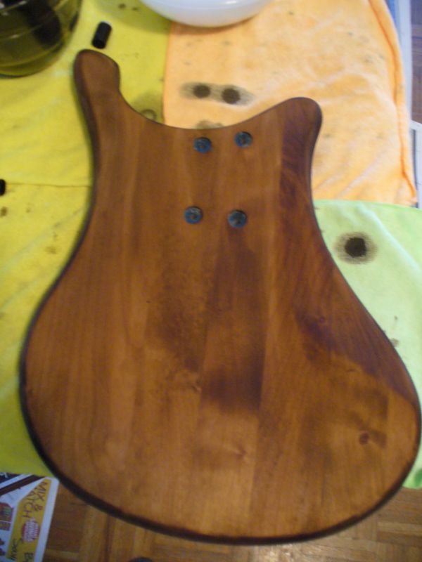

Raised the grain and sanded back a few times until it was smooth like baby child. Staining time, yo.
I took these right after applying the stain, looks like butt when it's fresh and is being absorbed into the wood at different rates. You have to be really fast and try to blend the stain into itself while wiping. As always, the sides are no fun. Probably best to do them first, actually...oh well.
AW MAN THIS IS THE SCARIEST PART
PLEASE DON'T BE AWFUL WHEN YOU'RE DRY

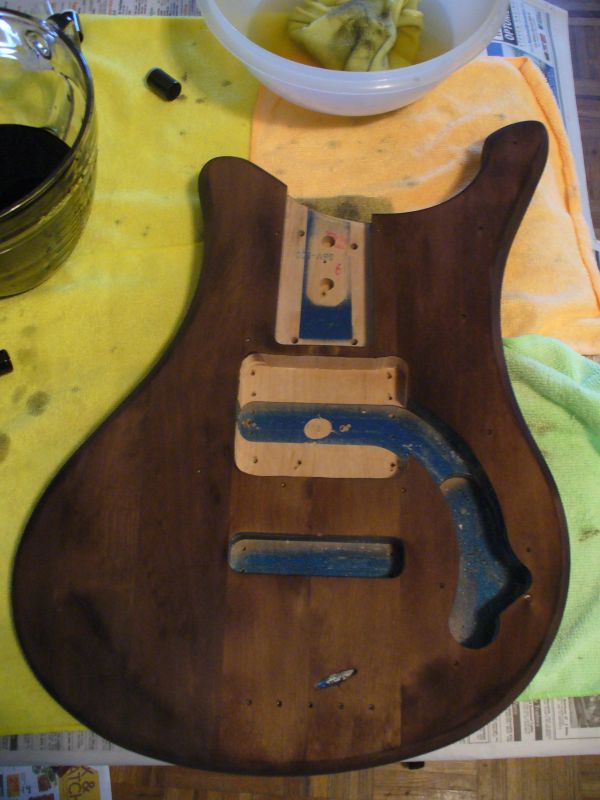

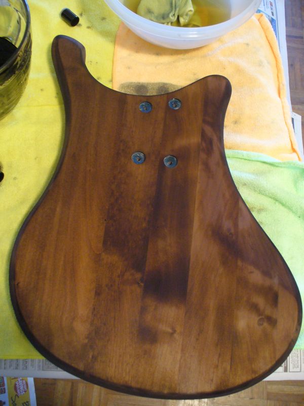

ROUND 2 SON, NOT EVEN DRY YET BUT WHATEVER
Still all splotchy and stuff 'cause of the fresh seepage. I kinda like this amount of...uh, darkness. Saturation?
This is where I stop until tomorrow, hopefully it'll be nice and even by then.

I did another round of stain yesterday, but it felt too saturated so I wiped a little of it away. Without some black dye or something mixed in, it's never gonna be as dark as originally planned but I'm digging it as is. Let it dry today while I did some other crap and tomorrow I'll take pics after wiping a few layers of Tru-oil on. Also started spraying the headstock black.
