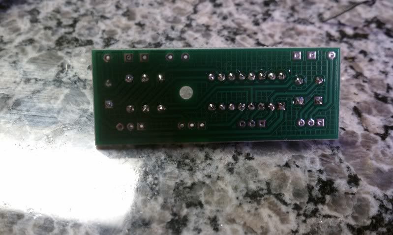

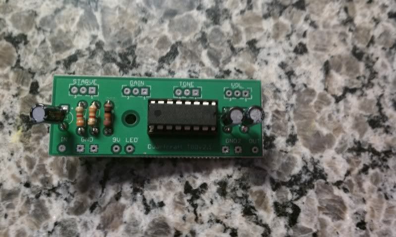

So anyone got these working yet? I just got my board populated. I've been out of town for two weeks and couldn't work on it. Hope I did everything right. First time populating a board.
Front of the board
Back of the board
Went to Radio Shack yesterday and bought a better soldering iron, some solder, a desolding gun (cause I fucked up), and some snippers. Totally forgot to buy wires though.
So I have to wait until my next day off to work on this again. Weak.
