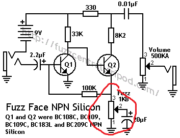

and will that perfboard fit inside the regular 'b' sized enclosure? real estate is at a premium these days...

Re: i want to make a fuzz face
make sure you know what side is negative on the polarized caps. and make sure the 0.01uf cap is not polarized. thats exactly the schematic I would use. you can also use other NPN if they are available. 2n5088 or 2n3904 are also good.
electrolytic = polarized
that big grey stripe is the negative side
I think you had it right on the order page. the pots can be 16mm to save money. I've never tried to fit 2 24mm pots in a 1590b so I cant say if it will fit.
the 1kb pot is a linear pot.
b = linear
a = audio
edit: I see you got it right
b = linear
a = audio
thats a 1kb pot with pin 1 to ground, pin 2 to the electrolytic cap, pin 3 goes to the 100k resistor and also the buttom of your transistor Q2. remember the negative stripe on the cap goes to ground.
