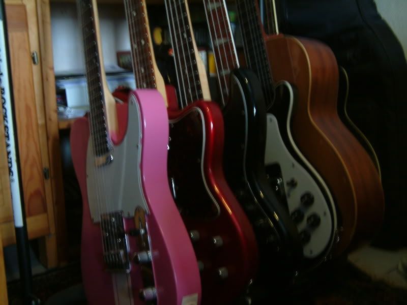

Squire Telecaster, Fender 2006 Toronado, Fender Jazzbass, Rickenbacker 4003, Some Nylon acoustic guitar and hiding in the back is a Richwood RB-102

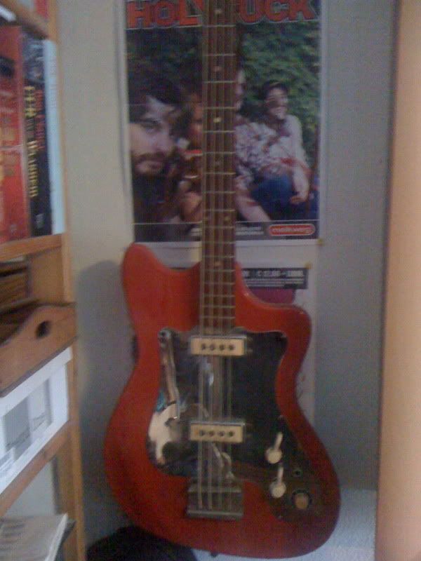

and then there is this short scale bass, home-made by some friend of my fathers friend. The body is cool but the neck is crap, still need a new one for it.

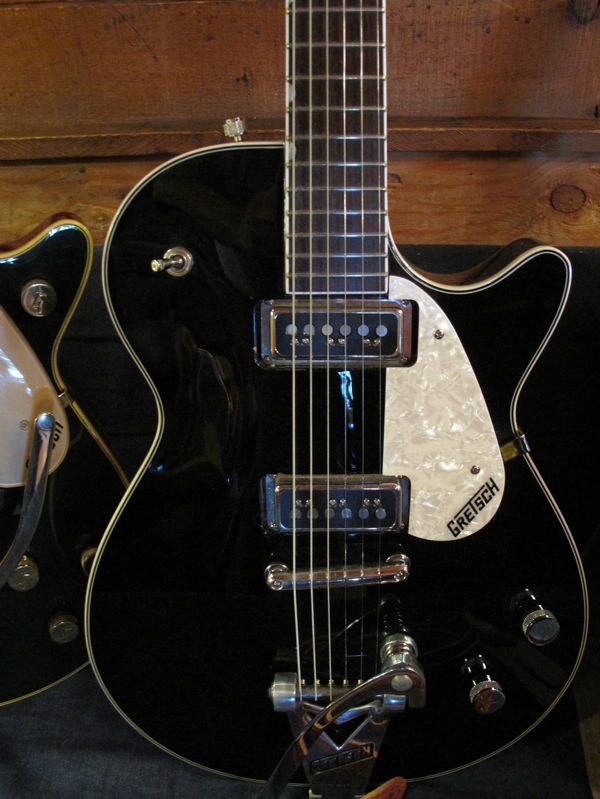

heavily modified Gretsch Pro Jet: added Dynasonic pickups, Bigsby B3C tailpiece (rather than the regular B3, because i really needed it to say "Gretsch" on there one more time :lol:), Grover Sta-Tite tuners, bar bridge, etc. Basically the poor man's Duo Jet.

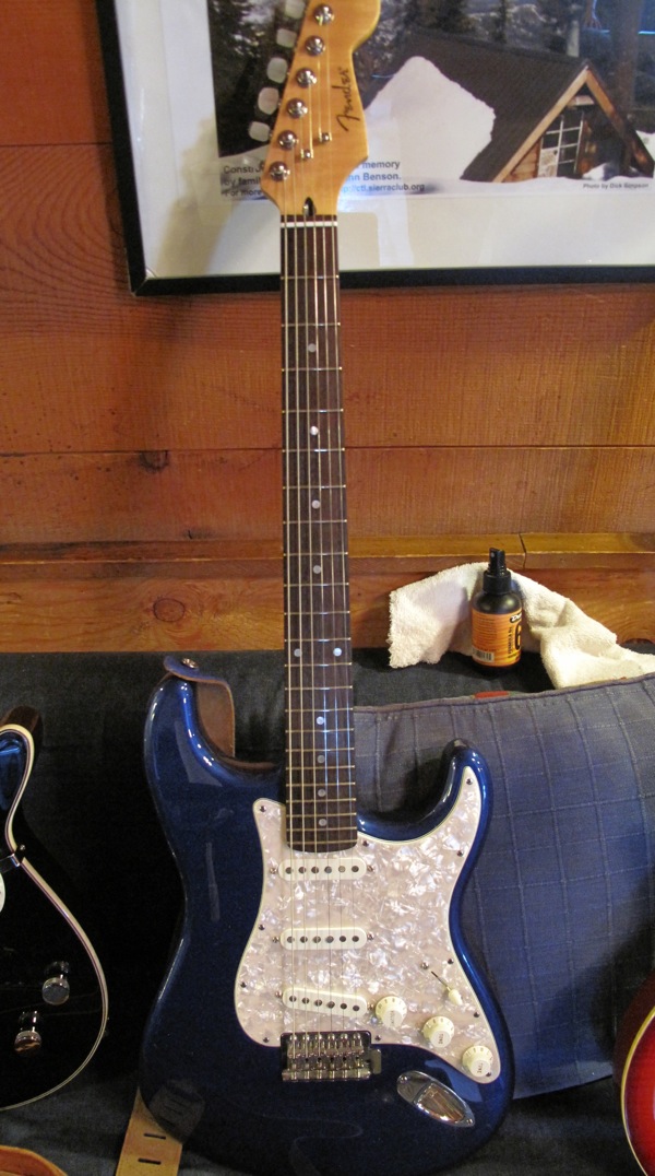

Strat parts-o-caster, built from Fender parts: MIK "Koa Stratocaster" birdseye maple neck w/rosewood board, MIM alder body, Fender CS '69 PUs, Grover mini tuners w/pearl Schaller buttons, StellarTone Tonestyler wired to middle/lead PUs. i also built a matching Telecaster to this.

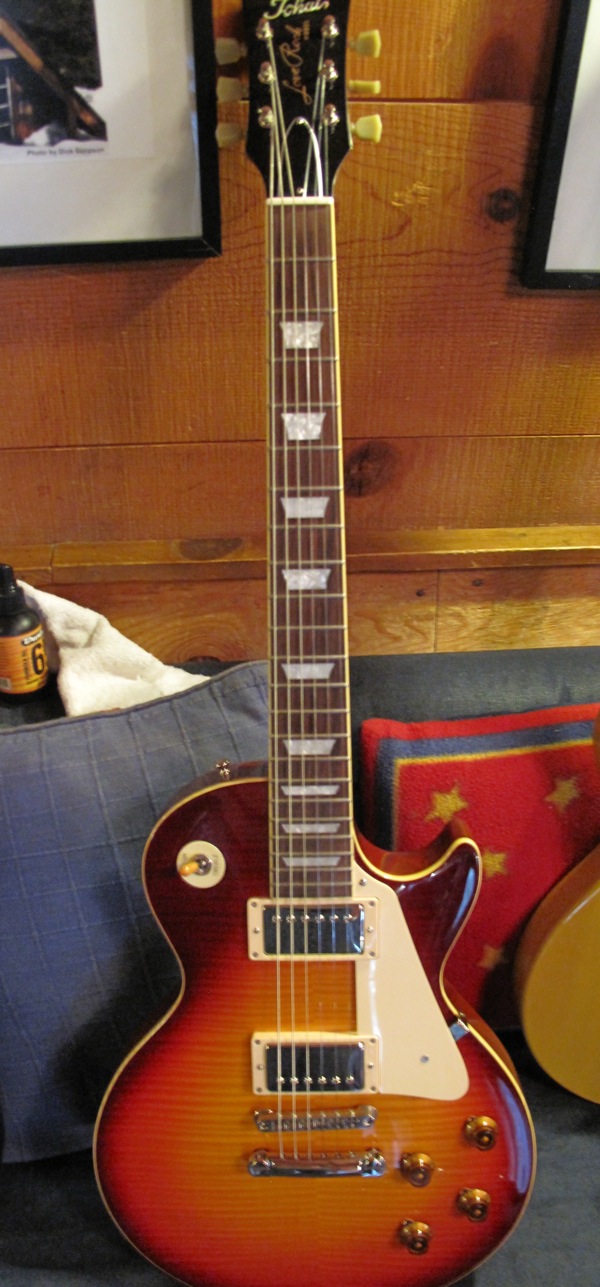

Tokai LS85 Les Paul Standard: 2 piece body, 1 piece neck, flamed sycamore veneer over maple top, dead stock.

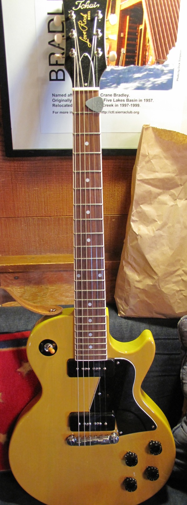

Tokai Les Paul Special; this is my favorite. 2 piece body, 1 piece neck, also dead stock. i love it when i get a new guitar and i don't have to do anything to it other than play it.

Those 2 Tokai LPs look sweet.

where are you located? if you're in the UK (or not, for that matter), i ordered the burst LP from Rich Tone in Sheffield and recommend them. they have a ton of Tokais, and mine arrived in California in immaculate condition and perfectly set up. they even held the guitar for three months on a 10% deposit. and this was on a guitar listed on eBay (where they have literally dozens of Tokais; you have to use Worldwide search from the US). i usually don't endorse retailers, but in this case i'll make an exception.

:omg:
I love this. It looks so much like what I was just scheming it's irrational. I probably glanced over this and it stuck somewhere in my mind.

thank you. :joy: getting the Dynas in was a little tricky. they're meant to surface mount but don't clear the strings if surface mounted due to the neck angle of the Pro Jet, which is shallower than that of the Duo Jet; and if you install the Dynas in the routs for the original pickups, there's an overhanging lip of wood from the guitar top which keeps the pickups too far from the strings for good PU response. the problem is that the PU covers don't quite fit because the flanges on the edge of the pickup covers are too broad. the best bet, if you have the tools, would be to grind down the flanges; alternately, you can remove wood from the underside of the top (which was my approach since i don't own a grinder) to allow the PU covers space to move closer to the strings. unless, like me, you're obsessed with the sound of DynaSonic PUs, it's way easier to retrofit FilterTrons; FTs more or less drop in to the newer (post 2007) Pro Jets, which are more hollow inside than the first ones to hit the market. however, several people i know of other than me have done the Dyna conversion, so it can't be that arcane :idk:; PM me if you're interested and i can tell you more.
the rest of the stuff was quite simple. the stock Gretsch "rocking bar bridge" drops onto the small-diameter Tunomatic studs on the PJ. the Bigsby, which might have problems with insufficient string tension and strings popping out of the saddle slots on a Tunomatic, has no such problems with the bar bridge due to the bar's huge, long slots. i've had the opportunity to A/B compare my PJ to similar Duo Jets and honestly i like my PJ conversion better for what i do.
