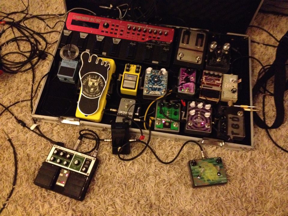

skullservant wrote:Recorded some loops the other night with this. The Mastery has made my life 10000x easier. My Jazzmaster stays in tune so well now
VP-> Comp-> Holy Grail -> Phase -> DL8 -> DD7
What's with thar DL-8 switch?

It was a pain for me to press the whole metal footswitch down to loop, especially since you have to hold the switch down the entire time you record, so I drilled a hole and added the soft touch switch for better accuracy and easier use! It's super simple to do as well

And really all you've got to do for the mod is connect two wires to the pads on the tiny soft switch inside that activate the pedal and connect them to the new switch. I've been meaning to make a solid piece of something to keep the large metal switch from pressing down at all as to not put pressure on the new switch, but it gets the job done just fine. I'm a pretty large fan of the modulated and tape verbs on the DL8, and the looper gets me by enough to not have to lift my dd7 off my other board 24/7

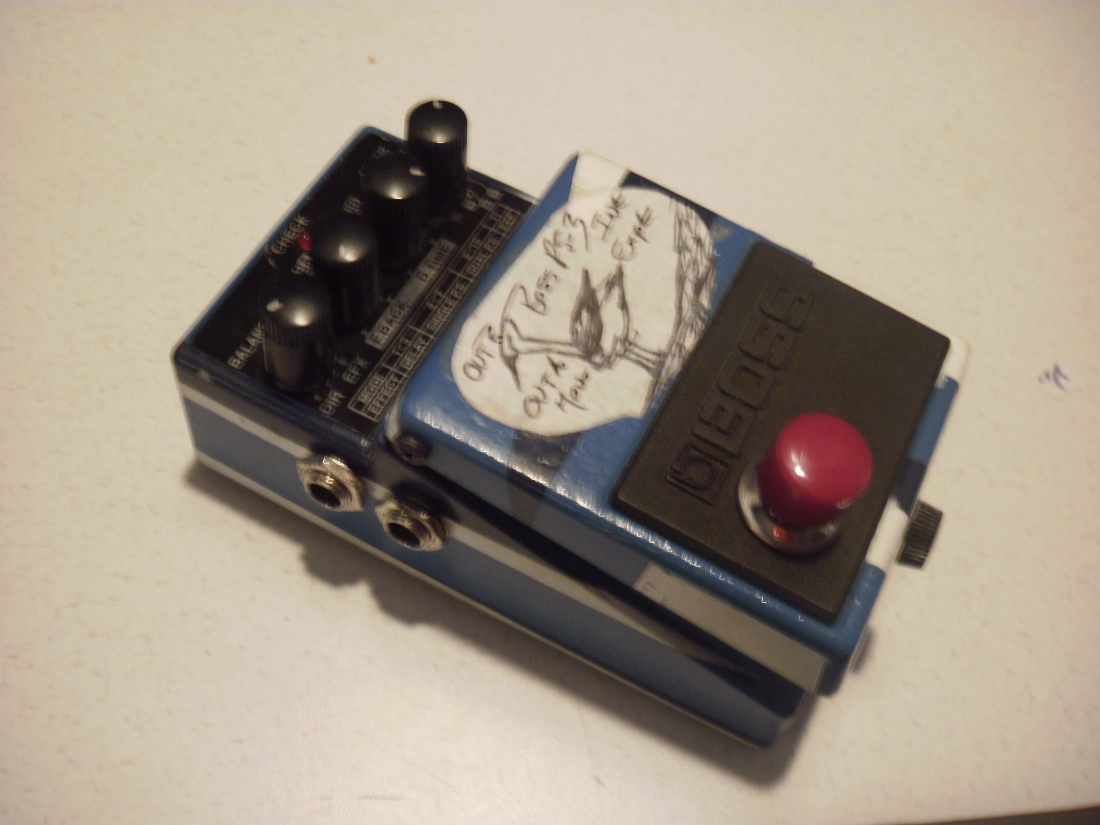

that's what I did with this bad boy
it came to me with no foot switch at all
now it's pretty
for some reason I assumed you couldn't do that with a DL8 because it is true bypass

skullservant wrote:It was a pain for me to press the whole metal footswitch down to loop, especially since you have to hold the switch down the entire time you record, so I drilled a hole and added the soft touch switch for better accuracy and easier use! It's super simple to do as well
Seems reasonable. The paddle depressers on the Hardwires are not my favourite, shame cause the rest of the design thought is great.
I wasn't sure if you were somehow using it in conjunction with the main footswitch to control something else.

Nah. Although it would be cool to find a mod for it, but putting the footswitch in there really limits how far the original paddle can travel.
And I thought so too Hbomb, but I'm thinking the DL8 and Deville's clickless true bypass with a momentary switch have more in common than I thought before. Both of them are just momentary switches, and a chip does the true bypassing somehow, I think

Relays. Used in the Dr.Scientist pedals, still true bypass but doesn't rely on 3PDTs.

oh ok like in the line 6 modeling pedals.....I Think
