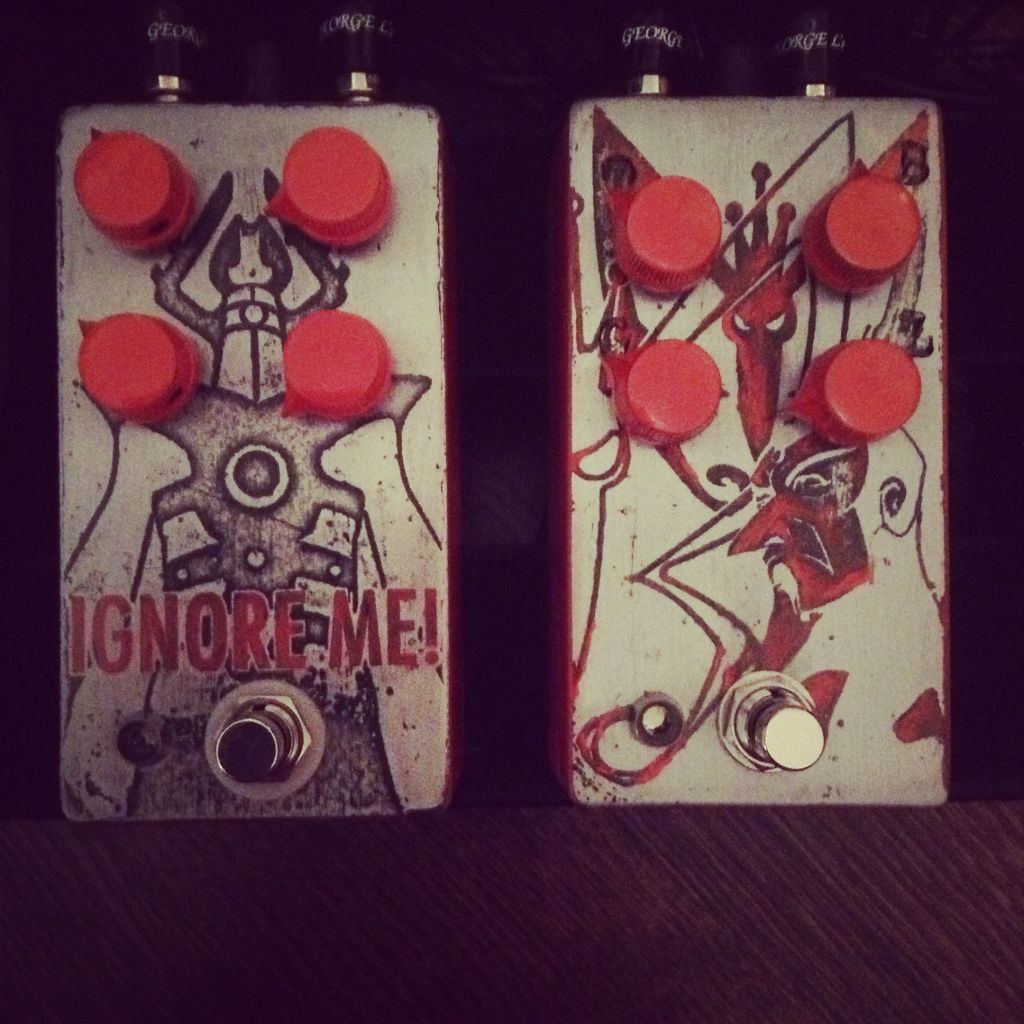

These two used together with these settings thru my Rig and Dingwall created the most perfect Distortion sound I've ever heard last night. It made me think that all I really need are these two and a suboctave pedal of some sort. I'm probably going to sell everything except my Source Audio stuff, which I guess means my FEA Photon, Opti-Fet and 3Leaf WonderLeaf.
The Photon Fuzz is awesome, but the Hoof has killed it for me. The Opti-Fet compressor was exactly what I needed for my compressor, was having a hard time of keeping my sound even. I don't have that problem with the Dingwall, so its too nice of thing just to have around. The Wonderleaf ultimately sounds better at what it does than the BEF Pro, but its harder to dial in and not as flexible.
I also realized last night how much I hate my home rig, I know I'm limited because of how loud I can play in an apartment, but the cab I'm using is a shitty approximation of my "big rig" tone.
So, I think I'm going to sell off the three pedals and pickup one of the new Second Voice Deluxes assuming and can do the suboctave that I need (it should do some Microsynth tones as well) and run a band board with the Hoof, Monarch and SVD. Then I'll keep the SA stuff on the PT Jr. Then I'm going to find a minor upgrade for my home practice.
