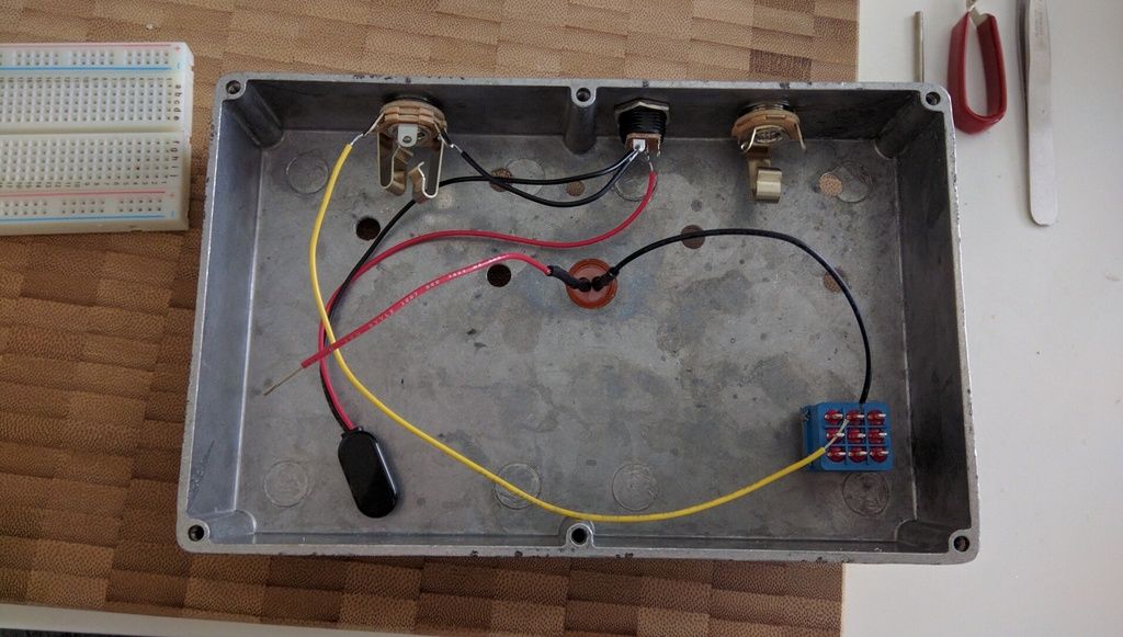

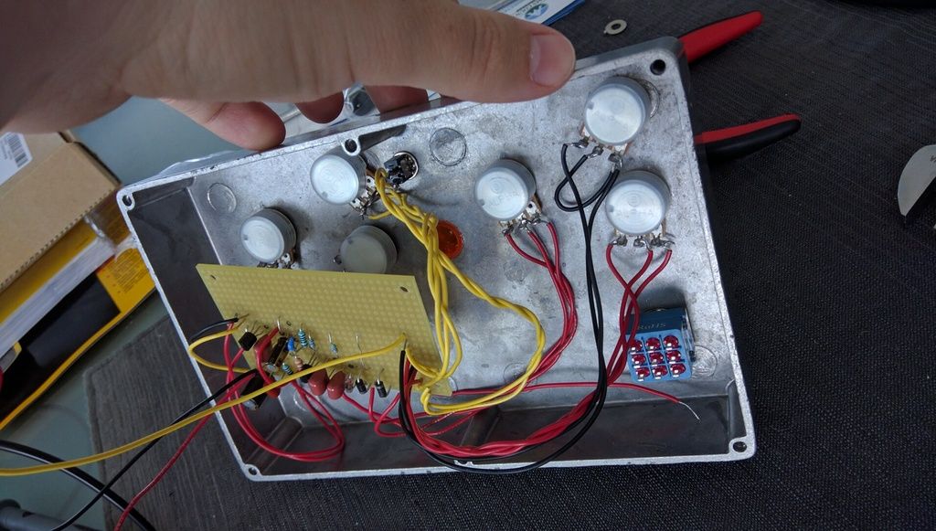

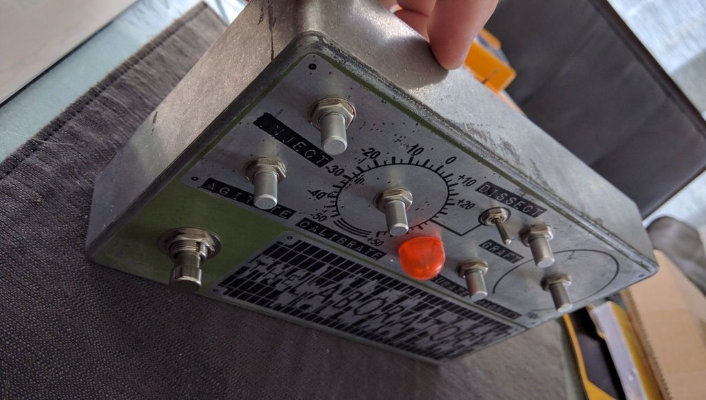

Time for a dry run on assembly to locate input/output and DC power jacks...
Only found a couple problems with how I soldered to the pins on the pots. No way I could have known that without having done this before, so I forgive myself those mistakes...they're fixed now.
Beginners: be careful to solder to the pins of your pots at an angle such that the wires will not short out against the pedal body when you tighten the pots down.

HighDeaf1080p wrote:Only found a couple problems with how I soldered to the pins on the pots. No way I could have known that without having done this before, so I forgive myself those mistakes...they're fixed now.
I usually wrap/bend them around the lug and cover the soldered lug with shrink-tubing.
Prevents any and all shorts.

Good call. So noted for all future builds. Not worth desoldering and resoldering 18 pins/wires at this point, since the guts of this are likely going to be replaced by V2.0 in a week or two anyway, once that clean boost stage is worked out and tested. On that one, I will definitely heat shrink everything I can conceivably do. On this version, I still plan to heat shrink the LED, since it will be right under the circuit board.
ALSO, I have a slightly different, skirted knob coming for the "calibrate" control...we will see if I like it better once it gets here. I think the smaller knob and large black skirt will add something to the aesthetics...but if not, I still have the knobs shown above, which rock.

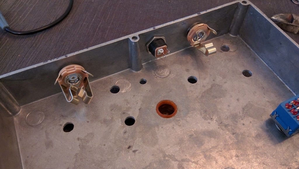

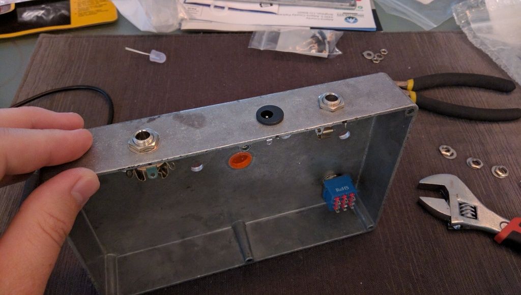

UPDATE: DC Power Jack and input/output jacks are installed...

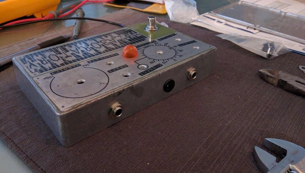

It's 99% assembled...just found out I don't have an Allen wrench small enough for the small knobs.
But the "shorting out/tesla coil" LED is working exactly as planned, and the pedal is making the correct sounds!!! Turns on and off as expected too...i am very thankful. Demo vid coming SOON!!

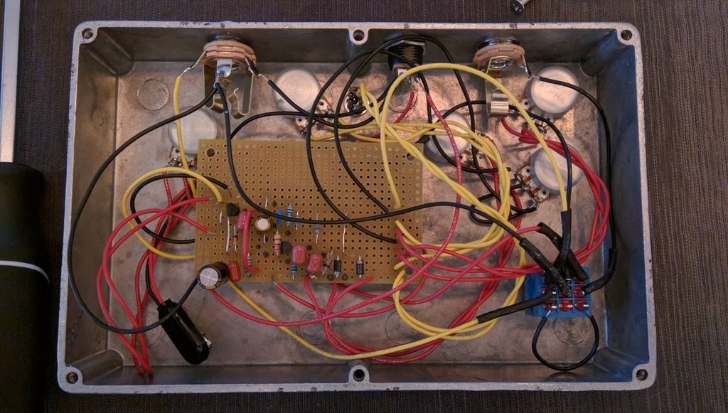

Ok, through near-final assembly, and extensive testing last night, I have verified that it works brilliantly, but that it absolutely DOES require the extra boost stage in the revised schematic. While several great sounds are there at unity gain or just a hair above...there are many amazing things to be had at well below unity gain...so, a-boosting we will go.
Given that, I have done a small vero layout for the boost stage this morning, and will work on getting that incorporated into the pedal while I wait for the tiny allen wrench needed to install the 4 smallest knobs. It fits perfectly in that blank upper right-hand corner of the vero board that's in the pedal now (seen in the photo above). For now I will just stick a tiny 7x13 hole second board on there with double stick tape, since future ones would likely be on PCB's anyway.

I just had a really rough evening with the breadboard. I thought I'd test the Veroboard layout I came up with for the clean boost before I soldered the thing...and lo and behold...i couldn't get it to work to save my life. I worked to bias the BS170 and ended up with different resistor values and still couldn't get any sound out. Then on a lark I decided to try a second capacitor on the input, and like magic it fired up. I don't understand why I need two 100nf capacitors in a row, but whatever.
Now I'm trying to decide if it changed the sound of the pedal or not, but it definitely fixed any volume issues. Dear god it's loud now!
I'll fix the schematic tomorrow to reflect the changes and then do some more sound testing. if it seems everything is kosher, I'll start working on soldering up the small added veroboard that I can stick in the pedal. But whew, I'm exhausted right now from hours of frustration. Glad I got it going finally.

I think your breadboard or your caps have a thin oxide layer that is causing a bad connection. moving things around and jamming them sideways is probably what fixed it if I had to guess. it is for this reason that I have mostly abandoned my breadboard. I use it to test fuzz face germanium and test LED brightness. that is all. building on vero is a better way to test things. you can add sockets to vero.
