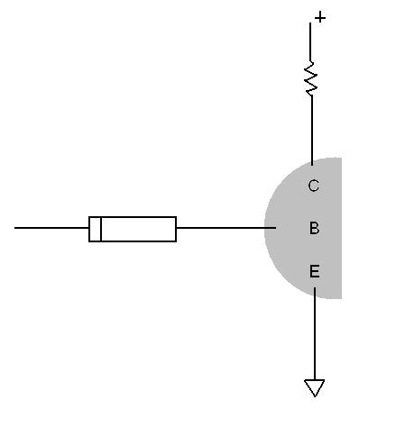

Can anyone explain how gating works?

Something like this?

I was actually wrong about the blue box. I went and checked the schem, and those diodes rectify the input signal, and use it to power the the output transistors-- so they're not powered if you're not playing.
You'd use two, back to back-- like clipping diodes in series with the circuit. And the diodes will need to be after a booster, since your guitar isn't going to have enough power on its own.

jfrey wrote:So if the diodes are powering the output transistors, does that mean they would be going to its collector?
And, when you say after a booster, do you mean after an amplifying transistor, or after a booster circuit?
I'm confused now and I'm not sure if what I asked makes sense.
The two paragraphs of my post were about different methods. In the Blue Box, the signal goes from an amplifier stage (OP amp booster), into a diode that rectifies it (cuts off the negative side, and leaves the positive), and that's used to power the transistors on the output.
Check out the schematic here: http://www.tonepad.com/getFileInfo.asp?id=73
D2 and D3 rectify the signal (I don't really think D3 is necessary), so that only positive signal gets to the collectors of Q2 and Q3. C8 filters it, because otherwise the transistors would be off half the time you were playing. I
It's a bit confusing... don't think about it too much if you don't get it. It's only done in the Blue Box. I just thought it was a neat way of gating.
The other way, as I said was used in some Peavey amp, you just put two diodes, facing in opposite directions (like clipping diodes) in series with the signal, so that signal below .6(ish) volts (if you use silicon diodes) will get gated off. So, just like what you posted, but with another diode, facing the other way.
