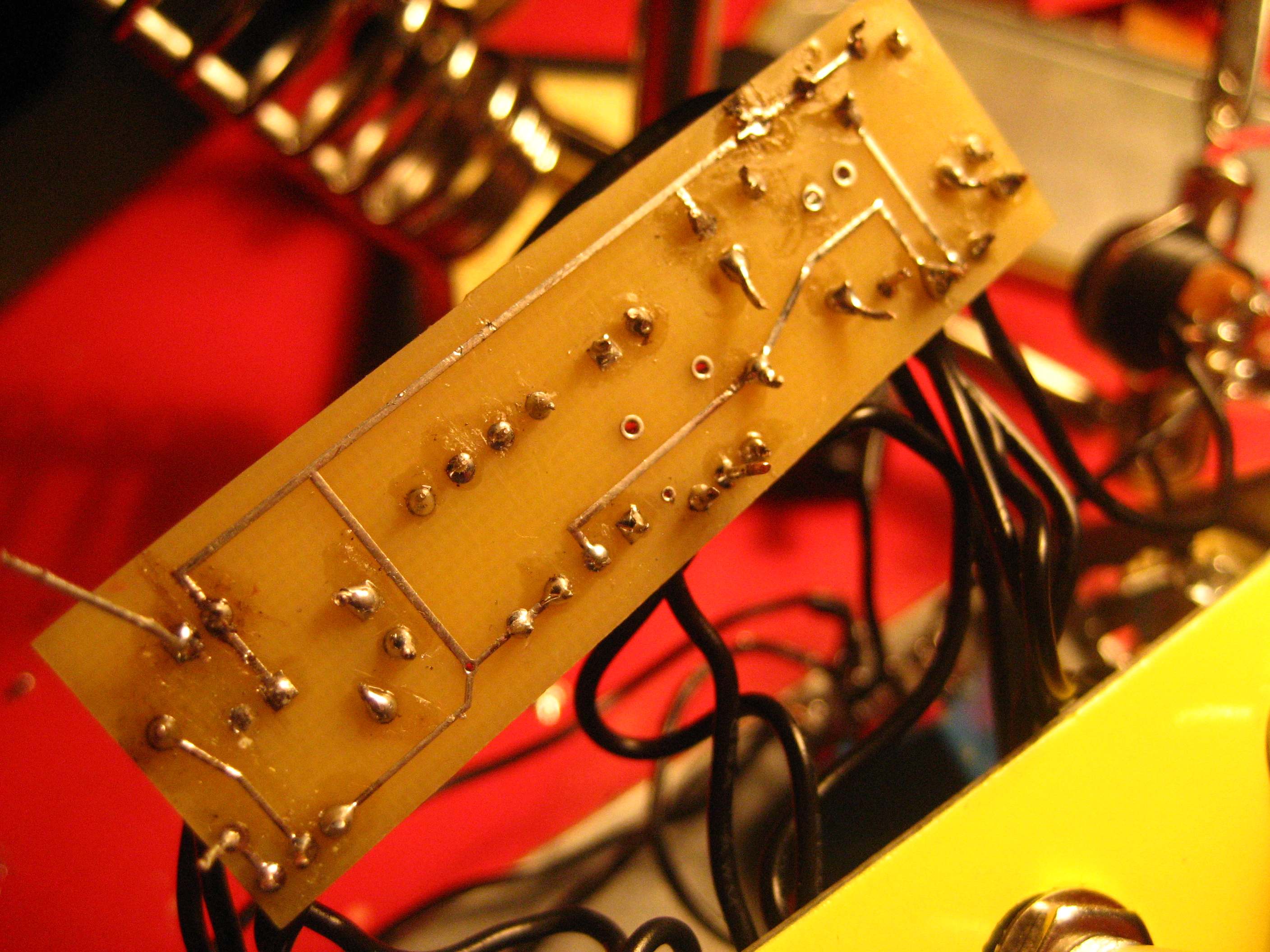

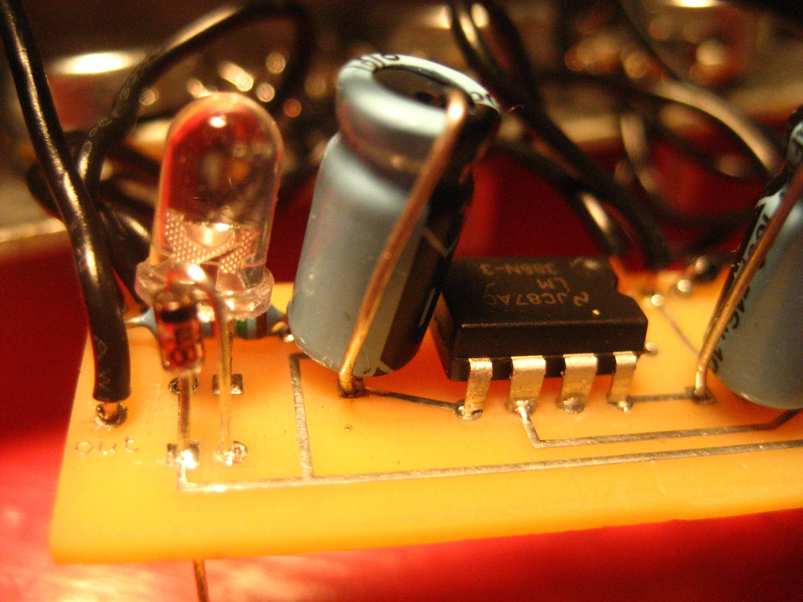

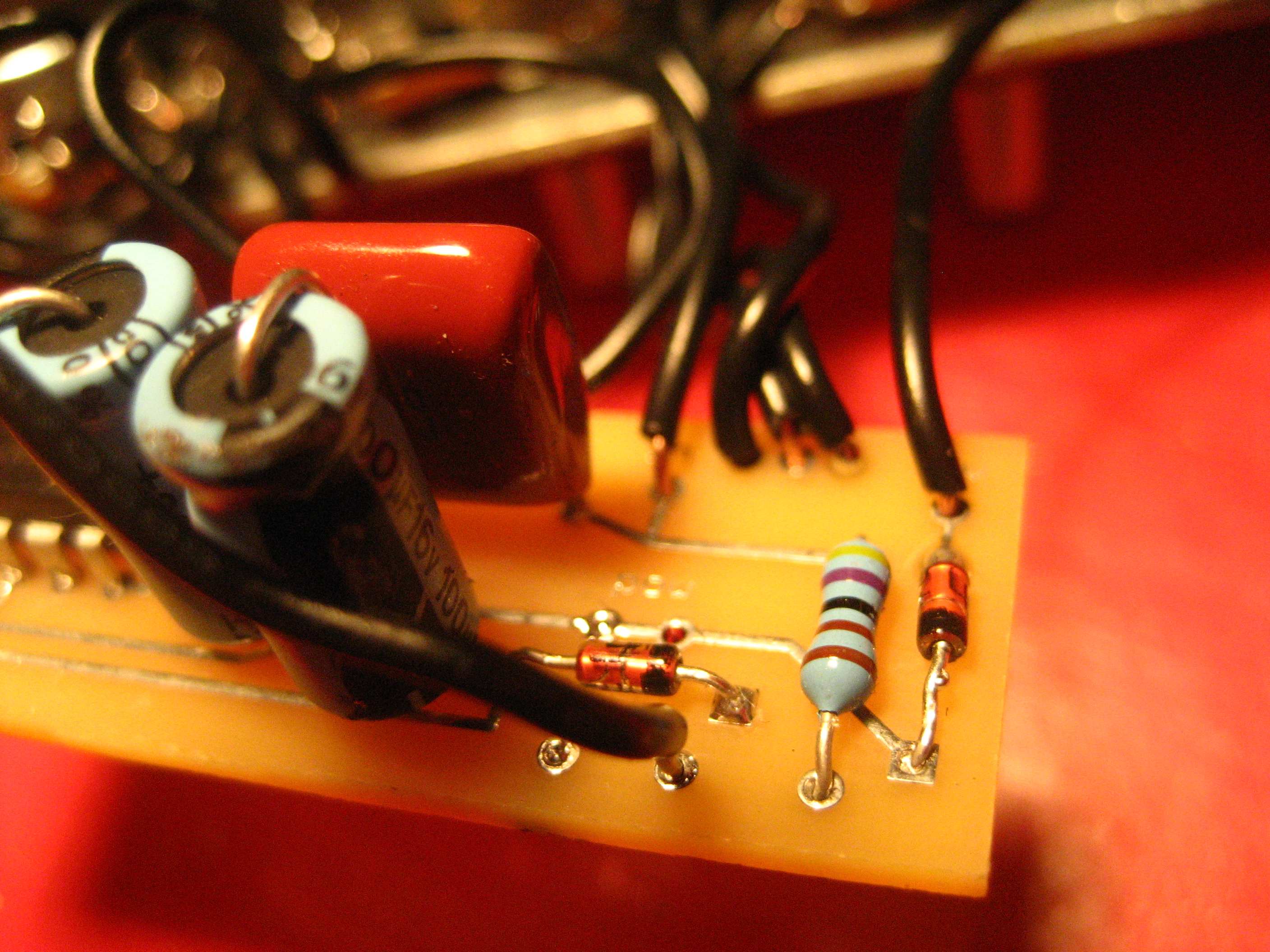

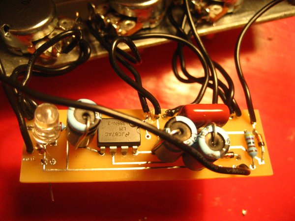

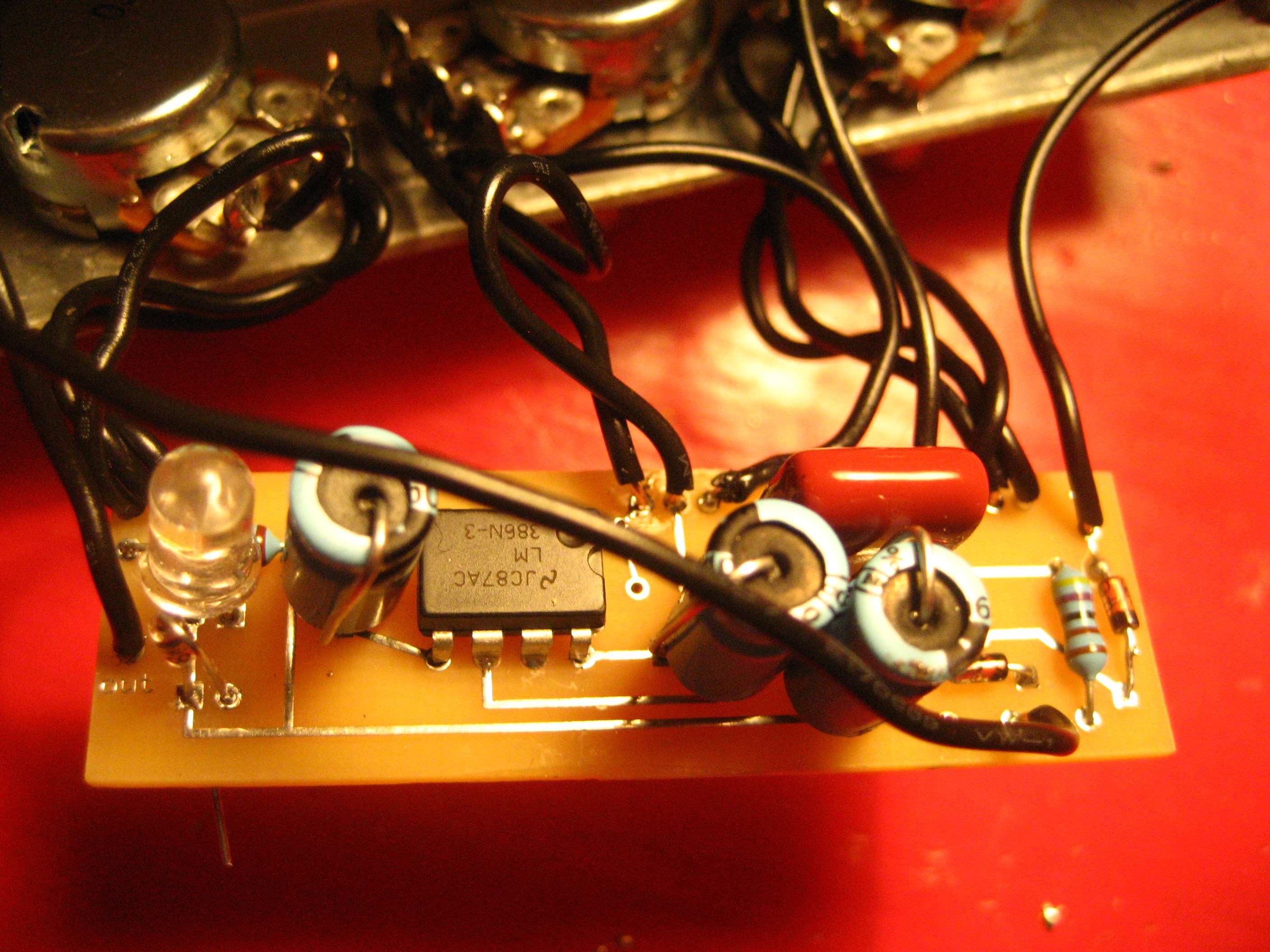

Ok, I just tried another wiring layout. Same exact thing. Working bypass, and a gates, fuzzy, quiet sound when engaged. So, it must be the circuit. I checked it all out and seems fine.
Here are some photos with my crappy camera....anyone see what the problem could be? Sorry for all of the posts, I'm just getting pissed that I can't get this thing running.

i'd socket that ic.
i had to go through a few till if found one that worked.
theres also a gut shot in this thread somewhere.
maybe double check youve got enough juice going to it and that polarities are right :idk:

And do you have your clipping LED in right? I can't tell which leg is in which hole...
Fun fact that I almost messed up: square is positive, circle is negative, longer leg of leds, caps are the positive leg, on normal diodes the side with the black band on it is positive.

Man, okay. I finally figured it out. I mixed up the 47k and 1.5M resistor. I had them in unmarked bags and read them wrong build populating the board. Hot damn, that was a pain...Great sounding pedal, although, not as much gain as I thought there would be. Thanks ya'll.
