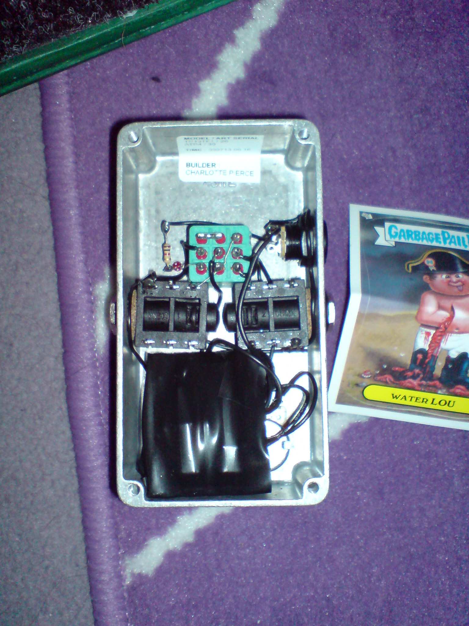

Hi
Well I took the back off and wtf, a garbage pail kid sticker inside!!??? Everything looked pretty well glued in place. There is something black which I wasn't keen on messing with. Here is a photo of the innards:
- Jwar
- Cosmic of BILF
- Posts: 18239
Re: $60 Torn's Peaker problem
Just write Devi an email. She's real easy to communicate with that way.

- adapt
- Posts: 201
- Joined: Thu Dec 17, 2009 1:28 am
i've fixed a torn's peaker that had the exact problem. the problem in my case is that the wires were too close together and the circuit is so high gain that it was causing interference. try playing a note and then moving wires apart until it stops, if it does.
will help you!!
- JohnnyC
- Posts: 322
- Joined: Thu Feb 25, 2010 5:14 am
- Location: Perth Western Australia
havent listened to the clip...but looking at the pic...looks like the jacks aren't grounded to the enclosure?
hang 2 secs ill get my ms paint skills on.
