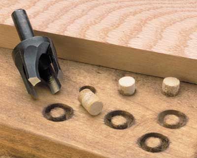

they sell precut wood plugs
the fancier the woodworking store
the more wood choices theyll have
or you can order them online im sure
another option is a plug cutter
same idea but you cut your own
and if theres a space under your pickguard
thats not routed with a bit of meat
go for it(or dont,that could be disasterous
and itll match perfect
i use these things fairly often
and if you have a few to choose from
you can match the grain pretty well
and theyre tapered
so most of the glue stays below the surface
a dowel might give you a ring
unless you taper that a bit
but then you have the same idea goin
and if you line the grain up itll never split on you
other material doesnt expand and contract like wood

i did not know that the hole plugs existed. and the plug-cutter is BRILLIANT.

its a lot nicer with a drill press
but if your only doin a couple its ok
also either have a big scrap of wood
or really tight clamp
clamp either way
but dont try to hold a 2inch scrap of 1x4
and try to use tha thing first time
knuckle buster for sure
turns it into a propeller
heres all species of plugs and cutters
http://www.woodcraft.com/search2/search ... uery=plugs
they havem both at the dumpot and lowes
