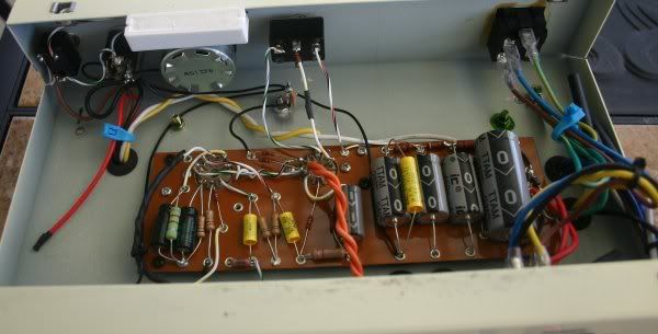

I did a pretty hefty mod job on mine. I removed the stock circuit board and rebuilt it all on an eyelet board:
I added a tone control and a pentode/triode switch. I also added an attenuator to make it more like my Univalve. You can crank it at low volume now, and it sounds better than using a master volume control. Full details here:
http://www.buildyourownclone.com/board/ ... =7&t=17363
