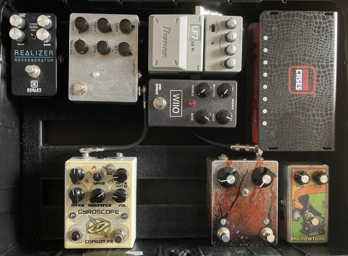

i swapped out the Realizer and put the Soft Focus back on the main board. i think the SF is better suited to the relatively normal board while the Realizer lends itself better to the specialized-processing section. that done, i decided to put the front-end board together as much as possible while waiting on the Demedash T-120 and Analog So High So Low to arrive which will (should) complete it. i really should just get a more compact power supply because it would make things simpler, but i don't want to spend anything more unless i have to so it's shoehorn-and-calipers time again. i revised the layout from the photo posted a couple of hours ago in the unedited version of this post to improve the ergonomics...now all the boxes i need to adjust with multiple foot switches are on the bottom tier in normal orientation, while the WIIO and Lo Fi that seldom get adjusted sit up out of the way. i'm tired of dealing with boxes that are rotated 90°...at one time that was common on the main board because it helped the old arrangement work, but i never liked it. the Shallow Water still has to rotate as does the SCF on the big board, but i don't adjust them that much. layout limitations:
--i have to have the boxes with tap tempo--the T-120 and the Gyroscope i squeezed in after hearing it on one of my old loops--oriented normally so i can tap
--the input is always on the bottom right for boards that work with a guitar plugged into them, because otherwise the cable gets dragged across the knobs and fucks your settings up
--output is usually at upper left to keep cables from underfoot
--clearance required in front of power supply for DC power cables
i have a 90° IEC adapter coming so i could mount the power supply horizontally rather than vertically (the power supply's AC port is on the left end so it's now mounted with that port facing out) , but i'm not sure that would work space-wise. all of this is entirely subject to change at this point, and will probably go through more iterations/adjustments to improve the ergonomics which is always a big concern for me. i don't need to make this any harder than it already inherently is.
note: since the Octron has to go at the start of the chain if i'm looping whether the FEB is there or not and there's no room to leave a open spot on the FEB, i'm just using a 9V battery and will unplug it when not in use. it only draws 12 mA current so a battery should last for months. i have some rubber feet around here somewhere.
prospective signal path: Mellowtone Hi Five clean boost balances guitar output levels->CMC Effects WIIO Hiwatt-in-a-box clone adds sponginess and crunch->Ibanez LF7 Lo Fi adds dirt and filtering->Stomping Stones Virus adds grain and distance->Analog So High So Low (goes in lower tier between Virus and Gyroscope) adds serious distortion and serious filtering->Copilot FX Tap Gyroscope adds woop-woop filtering->Fairfield Shallow Water soothes and distances->Demedash T-120 (goes at far left bottom tier, top jacks) makes Boards of Canada echoes->Realizer does independent-cinema reverbs.
new FEB 2 1-15-24.jpg (109.63 KiB) Viewed 3911 times
funny how this suddenly turned into a filtering module.

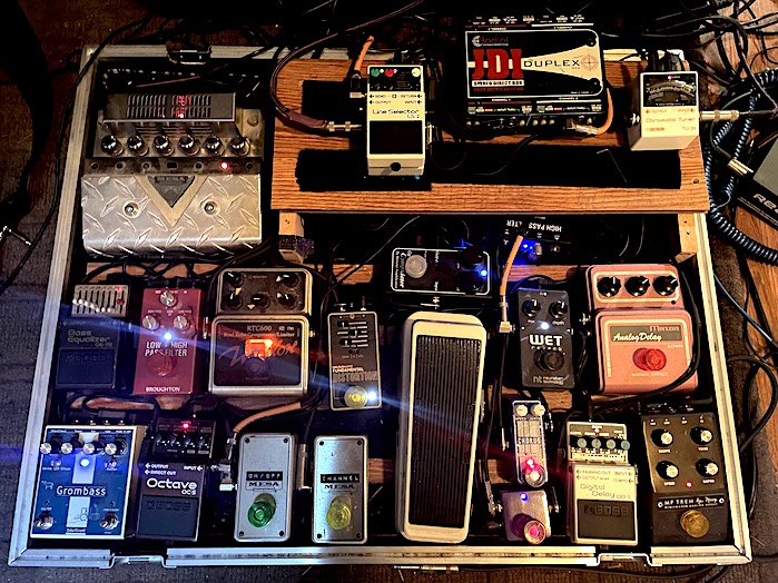

been a minute.. newest.. version.. added the walrus distortion.. it is loud! and the topper things.. found out the I actually didn't need all the high taming EQs for the cello.. just needed different strings :lol:
