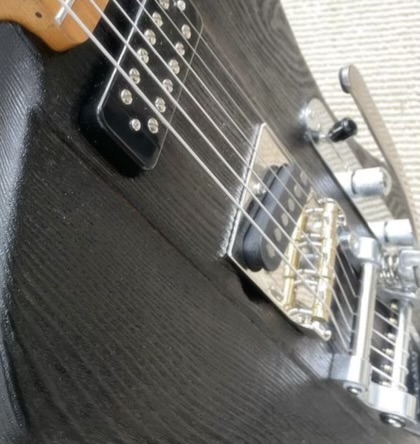

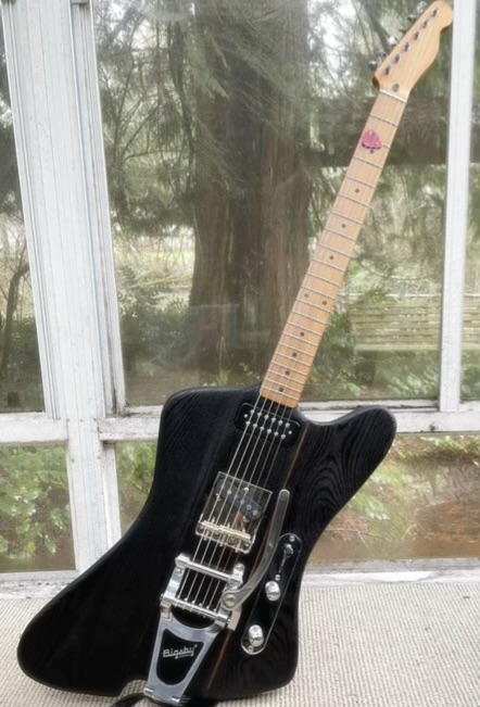

The one issue though if you use a large vintage style cupped tele bridge is a humbucker rout is wider so if you want “perfect” it won’t work.. here is my telebird I made a few months ago and I had what I had from another project…. I like the jank though..

I definitely embrace the jank, rather than run from it, so I don't mind if there's gaps with a tele plate. I may even do a filtertron style pickup and just use a hardtail strat style bridge, so there's options there, thanks for the heads up.
