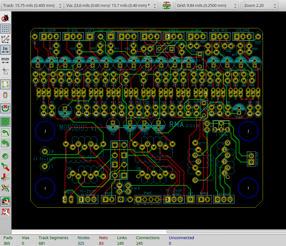

I'm currently building up the very last Monobius PCB (allocated). Everything up to this point has been on a circuit board that supported some old transformers from 1974 (doing the inductor duty, the diode ring so far has been Triad TY-141P). Since I don't want to run out of old iron I spent some time yesterday redrawing the PCB to accommodate a selection of either the TY-141P or the TY-250P which boasts a dual secondary which may pave way to some things I'm not ready to reveal just yet.
I'm happy to reveal the circuit board though:
This of course means that these will not be available for build for a short bit.
