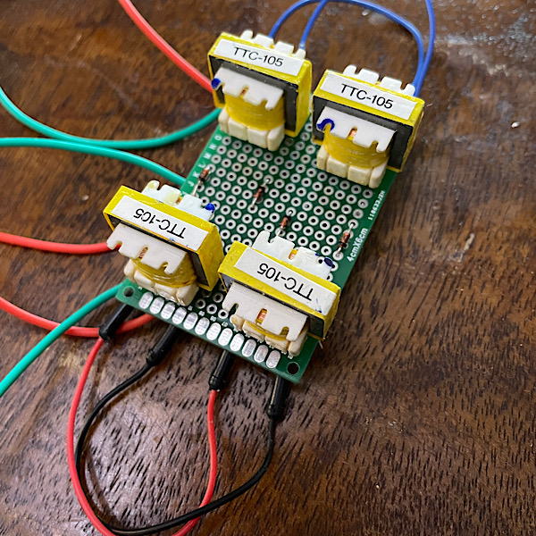

Post by lordgalvar »
Parallel telecom transformer passive diode ring

lordgalvar wrote:Image

That's super pretty, passive rings are the best. Rejection can be a beast though.

Yea, Cwejman passed away earlier this year. He was a great designer. The prices have gone insane.
Here is that passive ring mod from above. I have some other ideas using different transformers, but I guess the important thing is that it works?

...and picks up the radio.
Actually not bad balanced either once I got my carrier and modulator levels similar.
