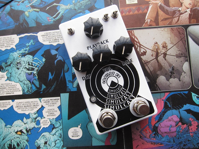

here is a quick radio video, 2 footswitches capture and bypass, 3 toggles (assign the exp to playback knob, play mode stutter or whole capture, playback fixed or variable playback), exp or cv in.

Glitch/Short Sampler Pedal, it has 4 modes
Momentary: Press to Play/Read the Buffer (otherwise it will be writing/recording)
Momentary Inverse: Press to Write/Record (otherwise it will be playing/reading)
Latch: Press once to Play/Read, it will keep reading/playing until you press again and then it will write/record.
Envelope: Sense knob set the level where the signal needs to go above to start recording/writing the buffer (if it's bellow it will play/read)
DIR: set the direction of how the buffer is read: forward x1, forward x2 (twice the speed so it gives the impression of being an octave above), forward the reverse (slight fluctuation on the pitch), reverse/backwards x1, reverse/backwards x2.
Size: Selects the amount of elements from the buffer it will read/play. Buffer size is aprox 2,500 ms or 2.5 seconds
Tone: High end roll off (buffer)
Dry: Volume of the Dry when recording/writing and playing/reading
Mode: mode selector (rotary 4 positions)
Sense: Only works in mode 4
Expression control (no cv unless is 0-3.3v, higher voltages may damage the pedal) for the size
Second Footswitch is for bypass (truebypass)
