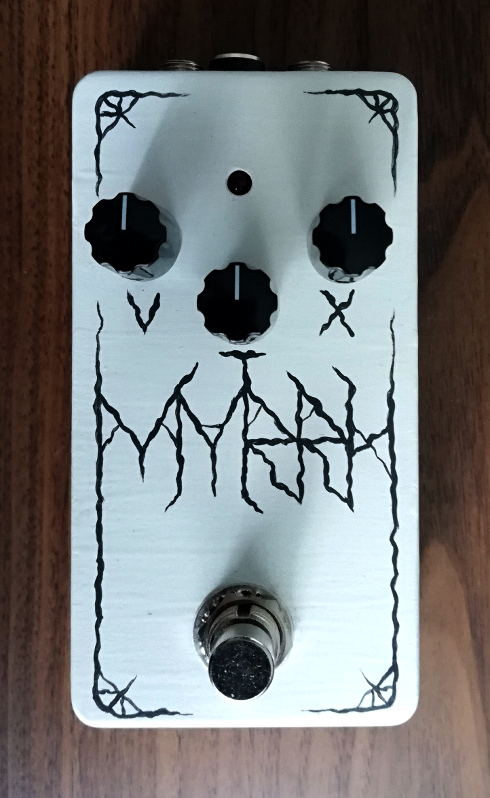

This started off as a Hipkitty Oxblood distortion, but morphed into a fuzz. Added the trimmers on the right, lower one up from 10k to 100k, which gave me leeway to audition a bunch of transistors in the three positions. Settled on, l-r: MP40, BC108, 2N3904. Dunno what to compare it to, but definitely something I don't have.. maybe most like a Meathead from the demos I've heard, but not as doomy and high gain. Will probably tweak it some more though, I set the trimmers a little below their max gain and volume before boxing it up.
Enclosure is a 1590B, had these enclosed jacks that seemed like a good fit, and they were. Of course I had to shave off some plastic and also grind down the lip on the bottom plate to make them fit, but other than that no major struggles. LED is red. Hand painted everything (except for the spray primer+matte clear coat). Named after everyone's favorite embalming aid. Surprisingly there isn't a black metal band called MYRRH, though there should be.

Love the look of that one
