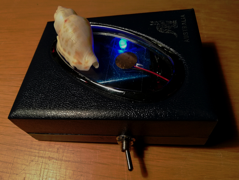

Looks rad! I see a Contact Mic and some rattley bits? Is the shell part of it?
- Posts: 42265
That looks like some kinda red caviar to me.DRodriguez wrote:and some rattley bits?

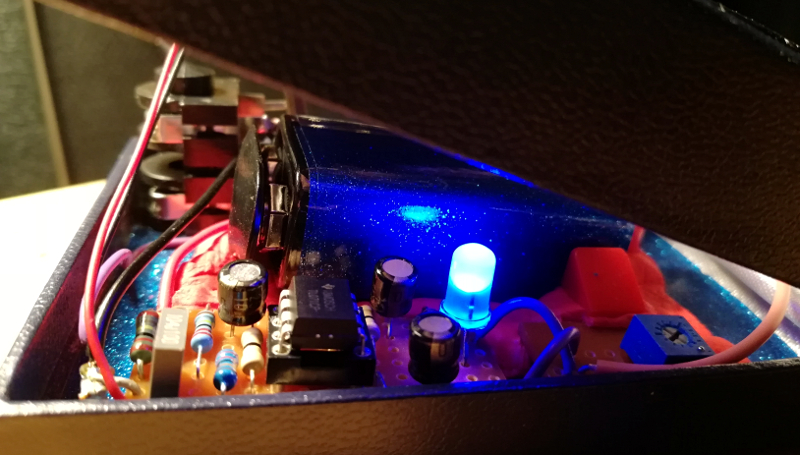

Thanks! Yeah, it's a contact mic with a TL071 preamp. Seashell is just sitting there, the red dots are dry water beads (when wet they look even more like fish eggs). Just some of the things you can put in the window and slosh around for noise. Box is a souvenir lighter case.

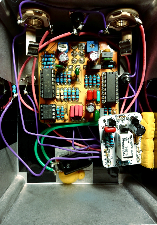

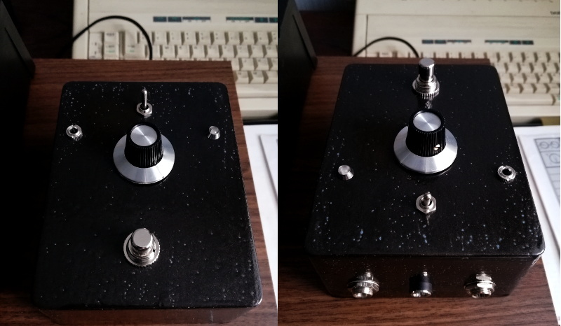

A board that went unfinished for months waiting for a 3-way switch, has finally been boxed up. Parasit Studio U-235, with relay bypass from the same. Why not, there was plenty of space for it in this C-size enclosure. Nice to have so much space. Not a super neat inside as usual, but no problems either except for the willy-nilly dual board wiring... Externally, grey primer and black Hammerite.
I really dig this circuit, it has massive subs and output. Tracks well (trimmer adjustable) and -1, -2 and detuned octave settings is perfect. And it's clean, unlike most my past and present octavers. Though I still want to keep the Sidescroller on board, since that can do the fuzzy and oct. up synth sounds in parallel. But it doesn't go as ridiculously deep as the U-235.

Some amazing stuff on those last pages!
Quite a lot of jacks on the ?E.Nigma?
... the Contrablast is brilliant
... and the contact mic box is great too.
I actually thought about making a box with springs'n'stuff using a contact mic, but I'm not too sure how to avoid that high pass filtering you get when you solder a contact mic directly to a jack. It's about impedance something-something, but I don't really understand ... Would it work if I put the contact mic through a booster like an LPB1 - or would I need to add buffer in front of the booster?

Looking great!
A buffer would absolutely be best. They are super easy to make though
Here's a couple different versions https://tagboardeffects.blogspot.com/20 ... ffers.html
