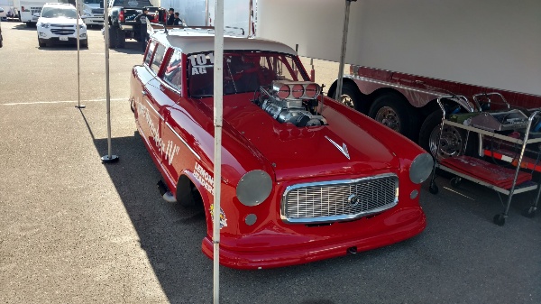

Mopar powered Studebaker:
Rambler
-Ring Mods!
"I make you chocolate"
