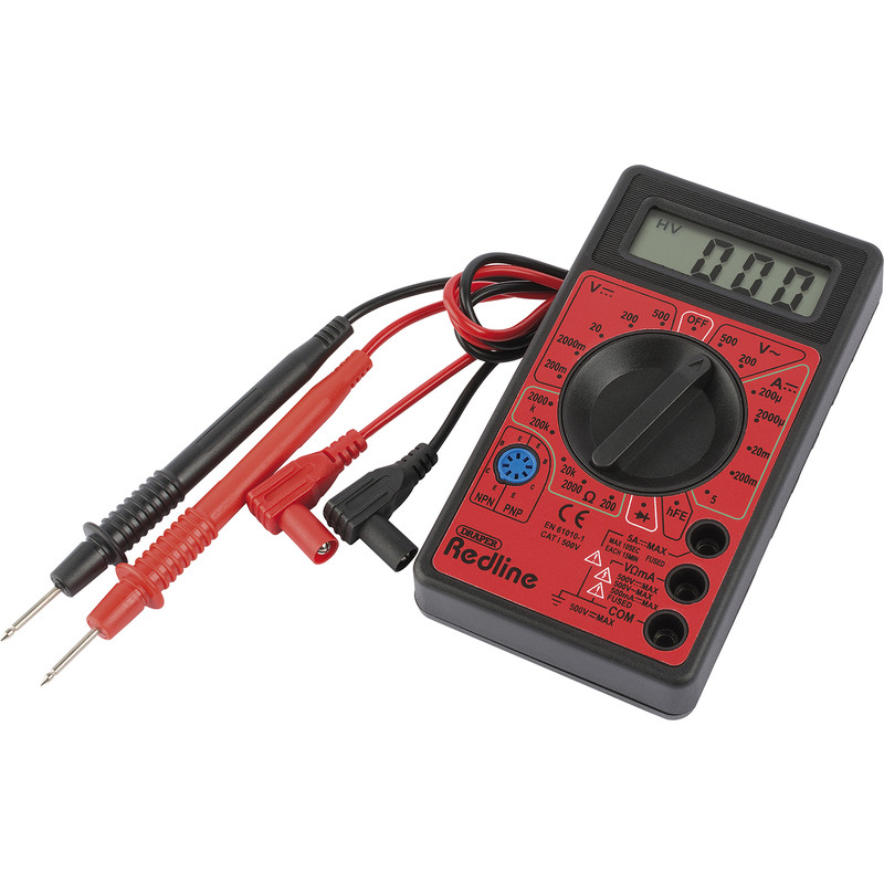

I bought this
http://www.toolstation.com/shop/p11867?table=no
I set it to voltage 20 and those are the readings I got
Do they seem to make sense to you? C10 and C12 struck me as a little odd, but then again I don't really know what I'm doing...

Swing the knob down to the ohm range and measure the 6K8, you'll want to set the dial to 20K.
Regarding voltage readings, what you have provided is meaningless to me, not having one to poke around.
After resistors: black lead to common, connected to ground set on DC volt (the one with the solid & dotted line) 20 range, read each leg of each transistor.
