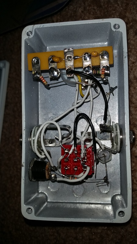

The other guitarist in my band got the Primal Breath and, well, it showed up like this. :erm:

That ad boasts a hell of a range considering its one knob. Can't watch video due to sleeping baby but the ad seems like snake oil.
Re: Black Temple Audio
That soldering is shit!
Hope it sounds good.
Looks like an Electra distortion variant?

The more I look at it the more I :facepalm:
Instead of doing anything normal (like using an electrolytic input cap, power protection, etc.) the whole thing is covered in 104 (.1uF) film? caps.
Two caps were connected in series (just a hair's width above the lug, I'm surprised it didn't short), presumably because the builder didn't own any .05uF caps.
Everything is a slight bounce from shorting (plus most of the wires weren't trimmed so there are bare wires just hanging out). The knob was pushed down so far that it made a groove in the paint. Paint's chipped with random flecks of coloured dust in it. :whateva:
I've probably seen worse, to be honest, but it's definitely on the lower quality spectrum of pedals I've looked at.
goroth wrote:That soldering is shit!
Yeah, it's like two Electras in series without any clipping.
The first part uses a 2N5089 and the second uses a 2N2222.
Also, the reason I got a look at it is because the volume doesn't actually work.
It almost sounded like it was acting like a bias control when it was turned.

Yeah that looks like dogshit. Would definitely fire back about that one.

jrfox92 wrote: Also, the reason I got a look at it is because the volume doesn't actually work.
This could actually be kind of cool if it was intentional.
