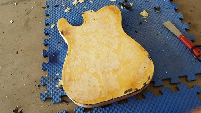

Update time. So here's the back, stripped of color, but still caked in the sealer.
On the end, you can make out the individual pieces..I think I counted six or seven.

Removing the sealer was sloooow going...chipped off in grains of rice instead of big flakes like the color coat.
And the front, post Fullerplast removal. there were two spots, one on the bass bout and one near the wiring route, were I went to fast or the sealer was just stubborn and took a bit of wood with it. No worries, I'll just fill it since I'm not doing a burst or natural finish.
