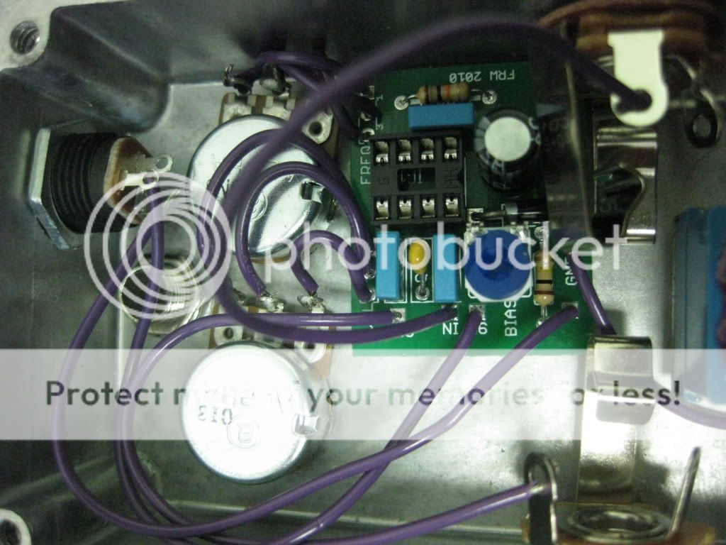

Hey, did I do this right? I haven't soldered the wires in yet and I haven't hooked up the dpdt switch but I wanted to double check before I went further. Also, am I correct in assuming that I should put some tape on the back of the pcb to make sure it doesn't short out on the enclosure?

Almost! The board IN goes to the TIP of the input jack. You have it hooked to the RING lug. Your SLEEVE (ground) connections are correct, as is the TIP connection on the output jack.
You are correct about insulating the board from the enclosure. Double-sided foam tape works, as does a folded up hooker card from Las Vegas.

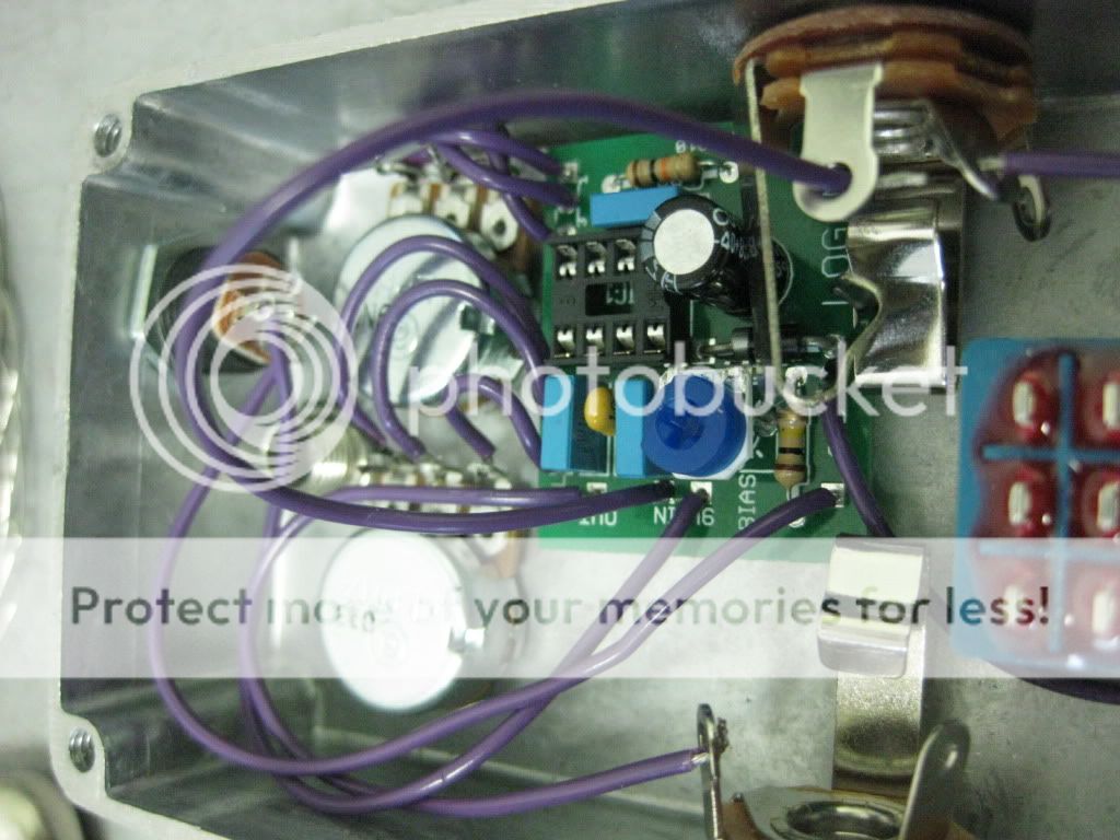

I built this and I get a clean signal, but when I engage the pedal, nothing. Then while the pedal is engaged if I pull the cable halfway out of the output jack a get a pitch that changes pitch with the frequency knob and bias trimmer. How can I fix this?
- Jero
- Posts: 11288
- Location: here
Re: The Official Logan 5 Ring Mod build thread
Check your tip/sleeve wiring on the output. Might have the something wired wrong there.
- culturejam
- Posts: 2381
- Joined: Sun Jun 28, 2009 5:25 pm
- Location: Nueva Yersey
Jero wrote:Check your tip/sleeve wiring on the output. Might have the something wired wrong there.
Yep. Sounds like the input jack is wired a bit wrong. Should be a simple fix.

New update, both jacks are fully plugged in, when I engage the pedal I get the same sound that I can change the pitch of, but I can play notes and they come out fuzzy about the same level as the sound.
