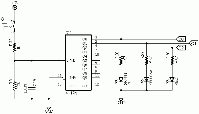

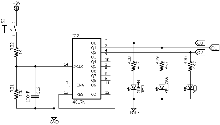

- eatyourguitar
- Posts: 3127
- Joined: Sun Oct 03, 2010 12:37 pm
- Location: USA, RI
Re: Potentiometer position switching
I would use the CD4066 for switching. I started drawing it but it is 27 switches driven from 3 control lines. this is a 9P3T switch. I can help you with the momentary switch debounce, the counter and the LED indicators. the switch debounce resistors and caps can be increased. there is a wide range of values that will work. you could do 100K pull up 1M pull down and 470nF. compare to 1K, 10K, 100nF.
