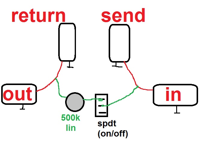

You could very easily turn it into an 'always on' type deal by directly connecting the red wire from the 3DPT to the blue wire on the feedback pot.

The SPDT is a feedback on/off toggle. So you could essentially have a true bypass looper with the toggle set to off, or the feedback on when the toggle is engaged. If you were to solder together the wires that that switch contains it would make it so feedback would be on the whole time while the pedal was engaged!

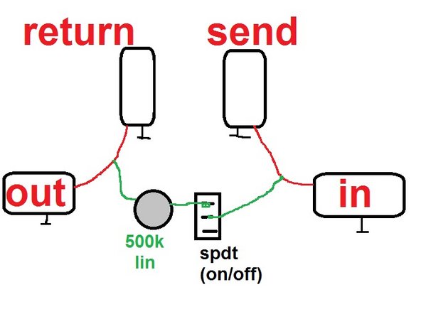

You could also just build my ghetto ass Feedback looper... If you don't need all that bypass looper stuff and just want your pedals to be either in a chain or in a chain and feedbacked.

Schlatte wrote:You could also just build my ghetto ass Feedback looper... If you don't need all that bypass looper stuff and just want your pedals to be either in a chain or in a chain and feedbacked.
exactly, especially if the delay pedal in question already has true bypass. you can make that a momentary or latching footswitch depending on what you want. chorus and flange gets a rocket ship sound or it just oscillates and screams. try it with at least one delay.

I prefer the "ghetto ass" version not just because you don't need the bypass part of it, but also because it doesn't need power. The only purpose of that power jack in the first circuit is so you can plug into a power source that will light up an LED when the pedal is on. Why waste the money on the jack and having to drill another hole in the enclosure only to tie yourself into needing a cord and being near a power supply? It's a feedback looper. You will definitely know when it is on. Especially if you use a momentary switch because your foot will be on it.
