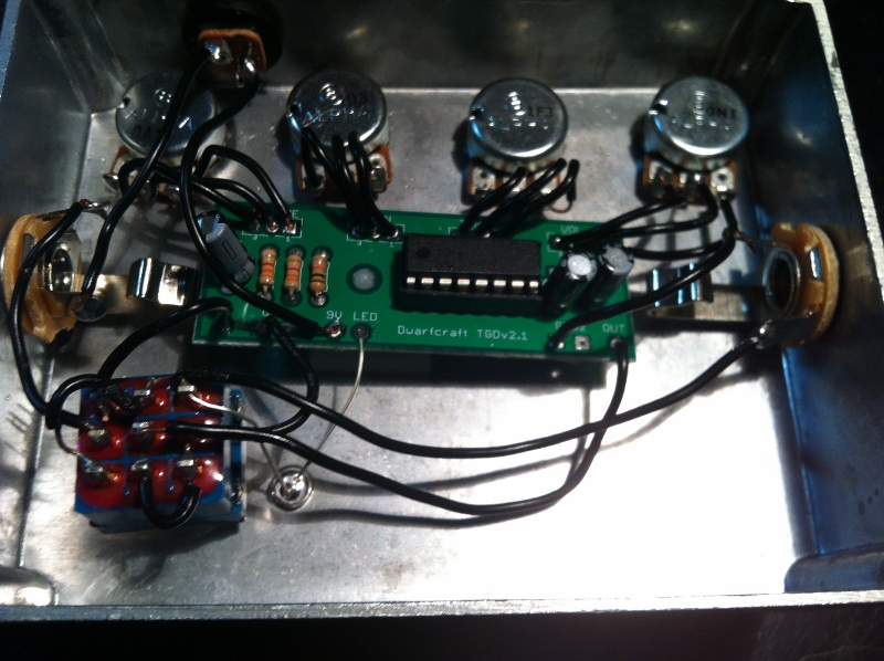

Can you take a pic of the whole thing? It is hard to tell from pics that are that close up...

Postby Jero » Mon Jun 11, 2012 2:59 pm
aens_wife wrote:Can you take a pic of the whole thing? It is hard to tell from pics that are that close up...
View them in another page, they are just big, not close up :thumb:
here, this should make it easy for everyone

Postby justin » Tue Jun 12, 2012 7:36 am
hey jus checking again.. should volume go from 0-LOUD in a somewhat linear manner?
Mine goes from LOUD-LOUDER.

Postby Nocentelli » Tue Jun 12, 2012 9:19 am
Have you grounded lug one of the volume pot?

Postby Jero » Tue Jun 12, 2012 12:56 pm
justin wrote:hey jus checking again.. should volume go from 0-LOUD in a somewhat linear manner?
I think it killed my Ampeg..
They are REALLY loud. and destroy. Hence the name :lol: Volume stays like 1/5 of the way up when I use it.

Postby space6oy » Tue Jun 12, 2012 4:49 pm
Nocentelli wrote:Have you grounded lug one of the volume pot?
there wasn't anything on the sheet about connecting it to anything other than its first point furthest left on the pcb, should i have connected it to something else as well?

Re: TGD Build! Ask yo motherfuckin' questions here!
Postby Jero » Tue Jun 12, 2012 6:08 pm
You're fine, the "1" spot on the board for the volume is connected to ground already.

Postby MrMurderMittens » Mon Jul 23, 2012 1:17 am
AAHHHHHHH!!!!!! is anybody else having a hard time putting the DIY TGD together?
I am fairly new to this, but this isnt my first pedal. I have built and rebuilt several times now, with no luck. Im wondering if i got a bad chip, but Im not sure how to test it.
I can post a pic later, but my gut shot looks exactly like the gut posted prior.
Anyways, im just curious if anybody else has had weird/ intermittent results.

Postby aens_wife » Mon Jul 23, 2012 3:07 pm
If you had wired it up with the power wrong at any point, you may have ruined the chip, which would cause no sound to come out. Send me a pm or email and I can get you another one for a couple bucks.
If you getting sound (the right sound!) intermittently, then you just have a short somewhere, I think.
Anyway, more details on what exactly is going on, please : )

Postby aen » Mon Jul 23, 2012 7:37 pm
aens_wife wrote:If you getting sound (the right sound!) intermittently, then you just have a short somewhere, I think.
Bad solder joint is usually the culprit here, but if you are shorting to ground it can sound the same.
