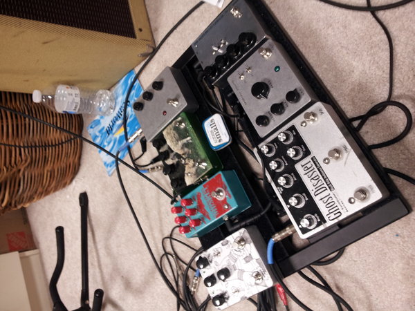

Haven't posted my pedalboard in a while. It hasn't changed since the l past time I rearranged everything,...but I am currently thinking about a revamp.
This is just sort of a stream of consciousness/trying to determine what I want. My main gripe with this setup is that I don't have the Feedback Loop or any of the fuzzes going into my delay,...just the Ring Mod,...and while that is awesome,...I feel like I've limited the potential for the delay by not being able to put anything else into it.
The pro is that I can set the tap tempo on the DL-4 prior to switching over to it.
So I'm toying with the idea of revamping the signal chain and having everything except for the DL-4 and the Tuner going into the input of the LS-2,...then having the DL-4 go in a loop of the LS-2 so I can set tempos,...then be able to switch it into the signal and still be able to delay Fuzzes, Ringmod, MuRF and Feedback.
The Tuner would be the last thing in the signal chain before heading out to mah amp.
Any fault in mah logic?
That is a HELLA AWESOME setup as you have it now :!!!: but I can see the usefulness of re-wiring like you said. Where does the Utter Stutter come into play? (where in the signal chain)
Funny, I was looking at the Utter a little while ago....ME WANTZ.

The Feedback loop is in the main signal chain (which is A on the LS-2; the Delay and Ring Mod being the only pedals in the B on the LS-2,...set to switch between the two).
So (if memory serves). LS-2->Compressor->Octaver->Supercollider->US. The US has the Shiva, WolfCPU, MuRF, and WSOU in it. Give me a moment to confirm that.
Over the past few weeks I've just been running a minimal setup at rehearsals as a result of Mecha Shiva focusing on writing and arranging (and a little bit of laziness). The result is that I've forgotten what my signal chain is exactly.

Postby warwick.hoy » Sat May 26, 2012 12:41 pm
Yeah,....I to wade through 22 pages of previous posts on TB and the last PYPB thread to find my signal chain.
Bass->LS-2 (A<->B)>TU-2->Amp
Loop A (Main Loop with Feedback Loop): FEALabs OptiFET>OC-2>Supercollider>Shiva>Utter Stutter (Feedback Loop)
Feedback Loop: 105B Bass MuRF>Wolf Computer>Wrong Side of Uranus
Loop B (Delay Loop): CA Ring Mod>Drasp Modded DL-4
And I was wrong,...the Shiva is not in the Utter Stutter loop. +1 :facepalm:

Well the thing is that I traded for that Whammy and it did not come with a power supply. It did however come with the PPAC. Which is awesome too, but I would like to stick another power supply under my board that actually powers more than one pedal. I like the Line 6 stuff ok but good God it's so big! Maybe an M5. I could see myself using that.
