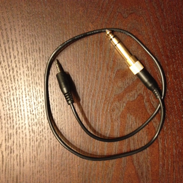

Re: Synchronizing it altogether
Post by nevada »
I did use a TRS adapter. Actually here's the exact cable:
I'm going to give it another shot. Your info is extremely helpful, and it makes a lot of sense to me. I think this should work... I read in the Volca manual that there' some sort of sync peak switch in the global parameters. Maybe that's equivalent to the normally closed/normally open thing?
I'm going to test this again tonight and report back. If this works... oh man.
